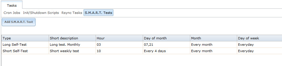

13. Set up SMART tests. Go to Tasks->S.M.A.R.T. tests. I recommend a regimen of Long tests every fortnight, and Short tests every few days. A lot of people out there think "short" tests are completely useless, just for full disclosure. Here's what mine looks like:
