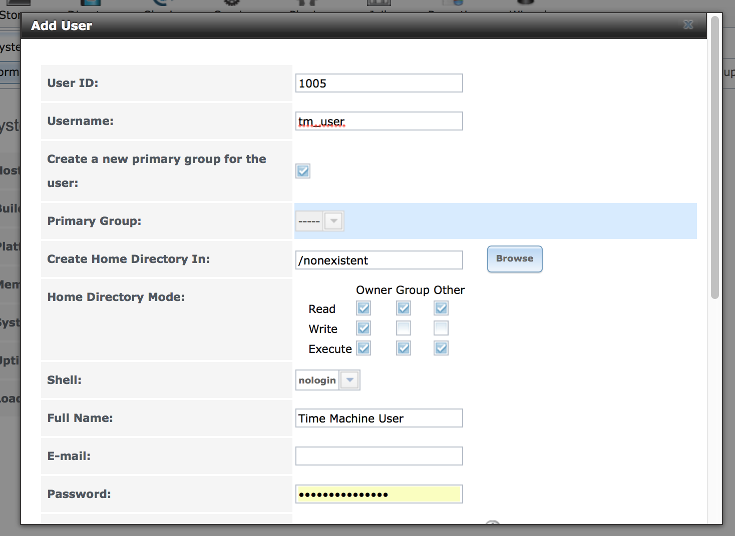

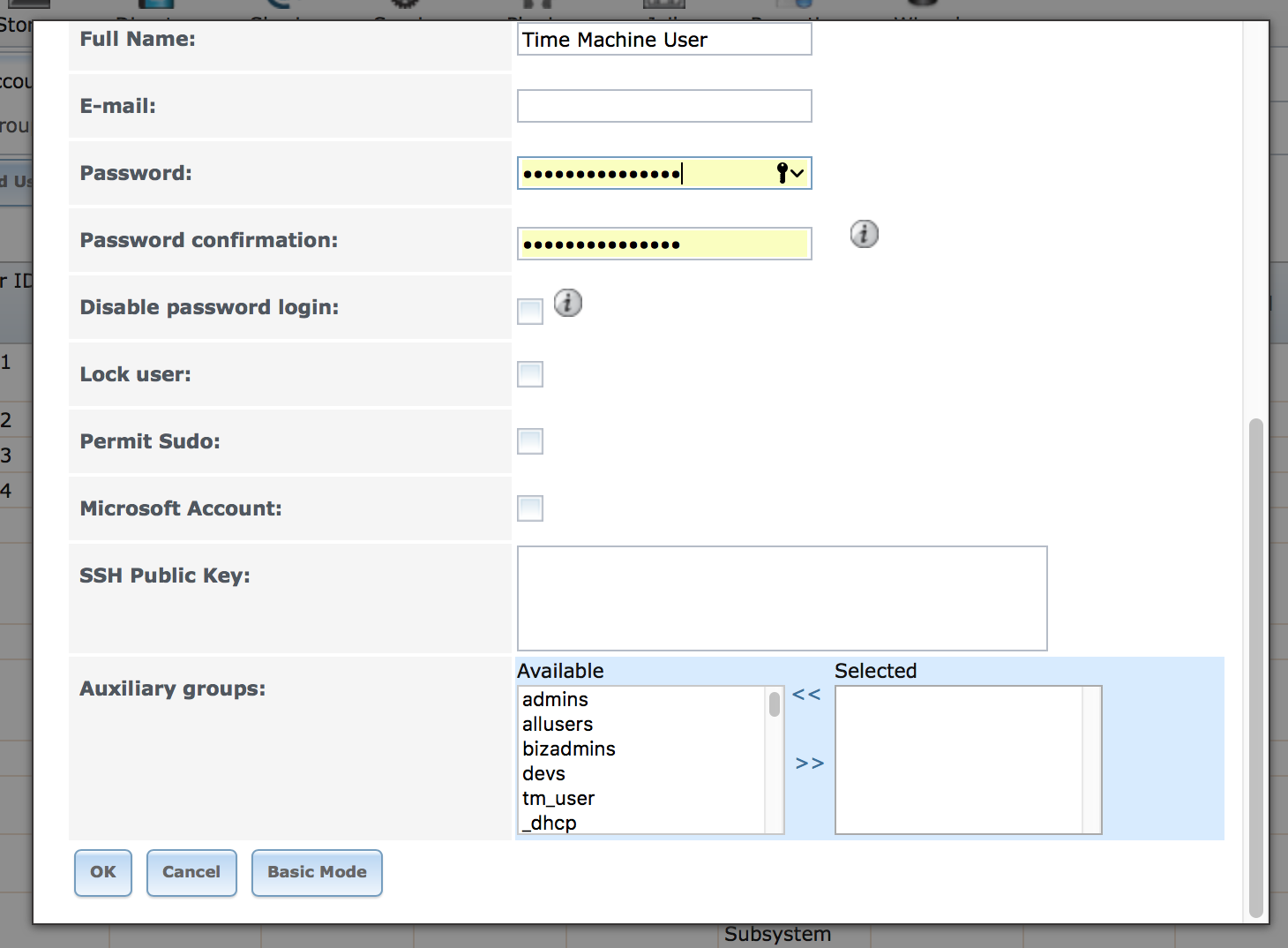

Firstly, create a time machine user.
From the left column, click "Account", then "Users", then "Add User"

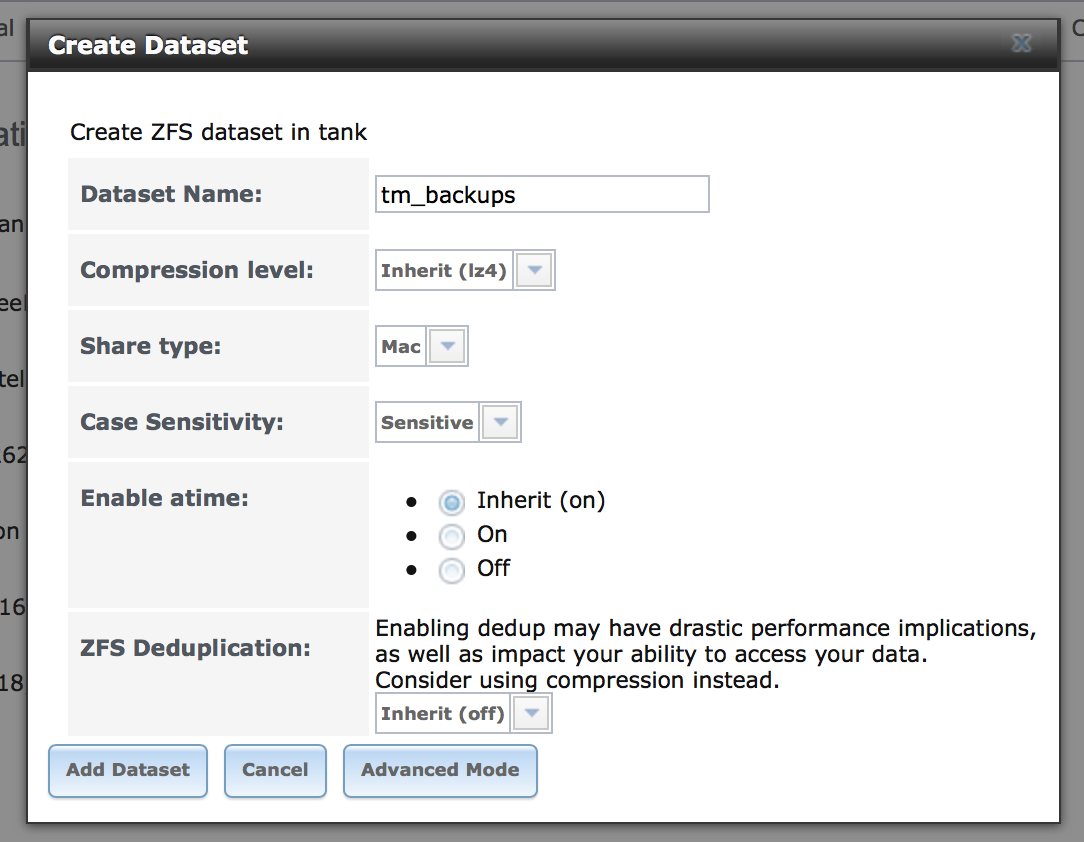

Next, create a tm_backups dataset
From the left column, click "Storage", then "Volumes" then "/mnt/tank" then "Create Dataset"

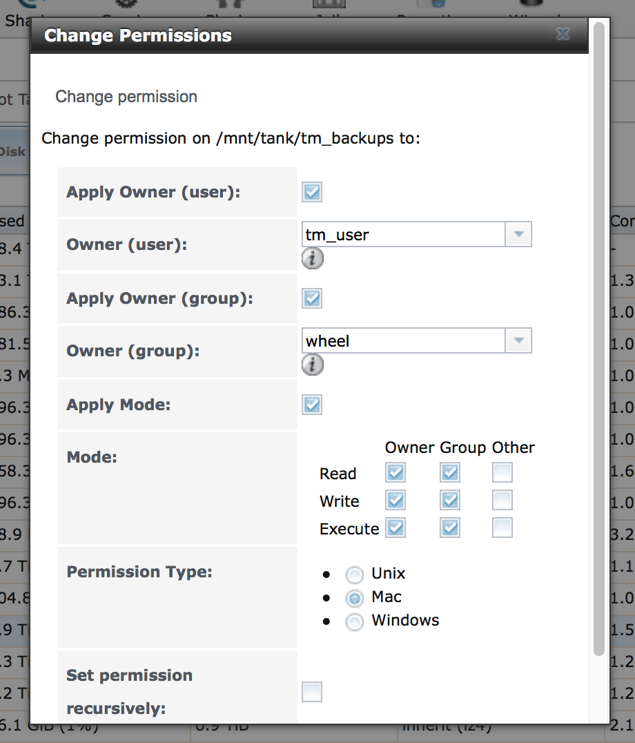

Once the dataset is created click it, then "Change Permissions"

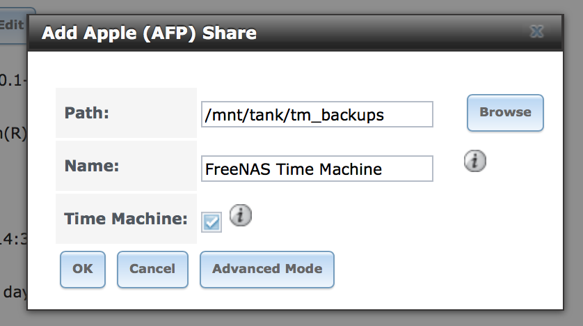

Next we'll setup the AFP Share.
Enable AFP serving if you haven't already, then click "Sharing" from the left column, then "Apple (AFP) Shares" then "Add Apple (AFP) Share"
Browse to your tm_backups dataset, or just type the path ie /mnt/tank/tm_backups
You should now be able to go to each of your Macs and select your FreeNAS Time Machine as the backup destination. login as tm_user with the password you set.
