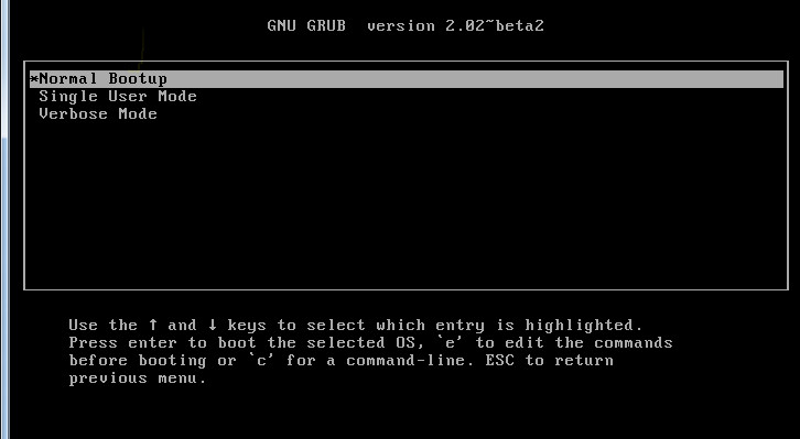

Step 1: GRUB loads.
Step 2: When you get to the GRUB screen (this is the screen that pauses for 5 seconds with the FreeNAS 9.3 option highlighted), IMMEDIATELY HIT THE ESCAPE KEY to stop GRUB.

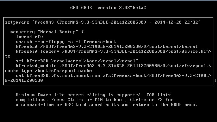

Step 3: Having done this, hit "e" to edit. You will now see a list of what we call loader tunables that over-ride default behaviors in the loader, and you will be in a rudimentary text editor similar to "nano" (if you are familiar with it).
Step 4: You will need to add your OWN tunable here, manually. That tunable is as follows:
set kFreeBSD.kern.cam.boot_delay="50000"
This is shown below. Note: do not scroll down too far, you want this entry to be in the "Normal Bootup" entry in this file. Doesn't matter really where within that, but do not go so far that you are outside of that zone.
This number 50000 is almost certainly much, much more than you actually need, but we think it would be impossible to need *more* than this, so let's just start with this number.
EDIT: We just had a user post later in this thread that said 50000 was NOT enough on his ASRock board and some (presumably cheapo) USB thumb drive, he had to go as high as 500000!!!!
Step 5: At this time, press F10 to BOOT. For this one boot (and this one boot only), your tunable will be active. When prompted, select "normal boot". Now, the GRUB will pause for 50000 milliseconds (i.e., 50 seconds), which is obviously ample (obscenely ample) time to let the USB bus do whatever it has to do.
