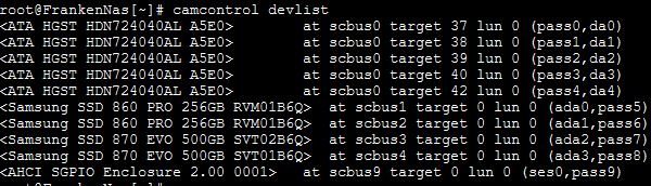

How are you connecting the drive?
Output of camcontrol devlist please.

"camcontrol devlist" results in the following:
