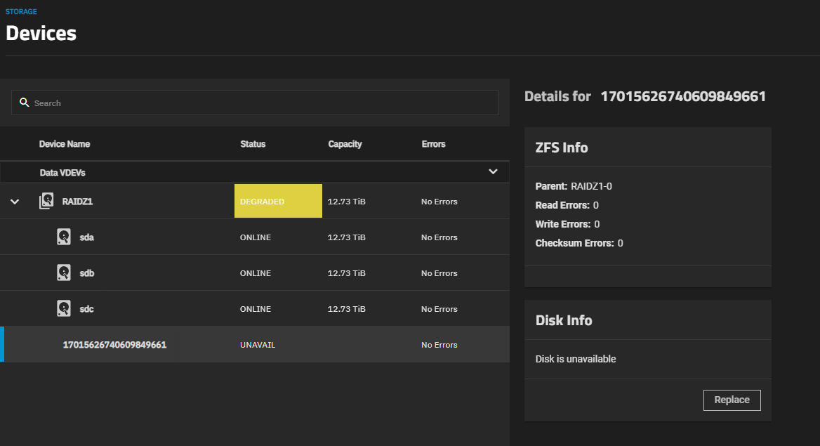

I had a drive fail on my pool (red overlay on the drive in the VDEV/Device list), ordered a replacement drive and went through the documentation steps to replace it. When those didn't work, I found the long list of posts about Failed= Offline, powering off, etc. I replaced the drive and powered back up, and have this now:

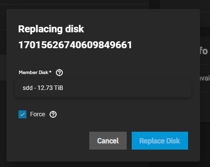

When I try the replace on the disk info, it lists the former sdd member in the member disk:
but this is the opposite of what the docs say (sdd should be the Replacing Disk, and Member Disk should be 1701..etc at least from my reading).

I don't understand the question. you are replacing the missing 1701 with existing sdd.

When I did that, the new drive appeared as the 1701etc (first screen shot), and when I tried to place it into the pool the second screen shot made it appear that 1701etc was already a member of the pool and replacement seemed to be the existing sdd.

Can you go to storage - disks and confirm sdd is currently not assigned any pool?
The identifiers sdX change between reboots. It may very well be that sdd is your unused drive. The former member of the pool 1701 is not available anymore, since you replaced it.

it looks normal to me; its telling you that you are replacing 1701 and asking which disk you would like to replace it with. it will not show already used disks in the list. the wording could perhaps be more clear.

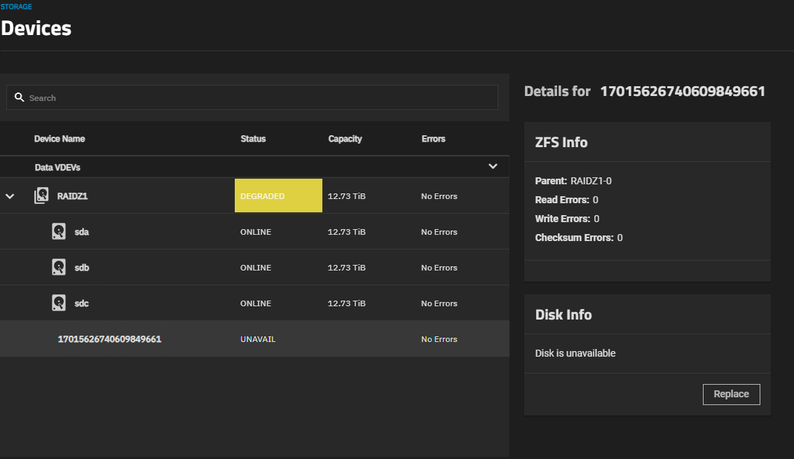

So in this screen shot:
The system thinks that 1701etc is already a member of the pool, even though the disk isn't assigned an id? Ok.
Is there a way to remove or delete it from the list of assets, so I can add it into the pool and restore the full functionality of the pool?

that is not a drive, that is a placeholder for where a drive used to be but is now gone/missing/etc. you need to replace the placeholder with a drive, which is exactly what the screenshot you originally posted is showing - replace 1701blah with sdd.
it seems like you are making this more complicated than it needs to be. the placeholder varies; /dev/(s)da, /dev/gptid, a string of numbers like here. it doesnt matter what it is, just replace it with a new disk.
truenas will only show unused disks in the replacement UI.

Yes, the dialog is confusing, its asking you which disk to replace 1701xxxxx etc with.
The answer is "the only disk which is not in use" which is the only disk in the list... which is sdd
