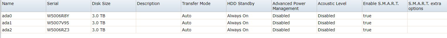

Those are the steps out of the manual, and if you follow them (make sure you remove the correct disk--it will be the one whose serial number isn't shown in your second screen shot), you should be fine. Be aware, though, that you're running your system with only half the minimum RAM. It's unlikely this will cause a problem with the disk replacement, but it's hard to say for sure.

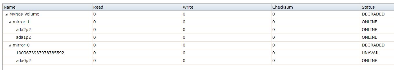

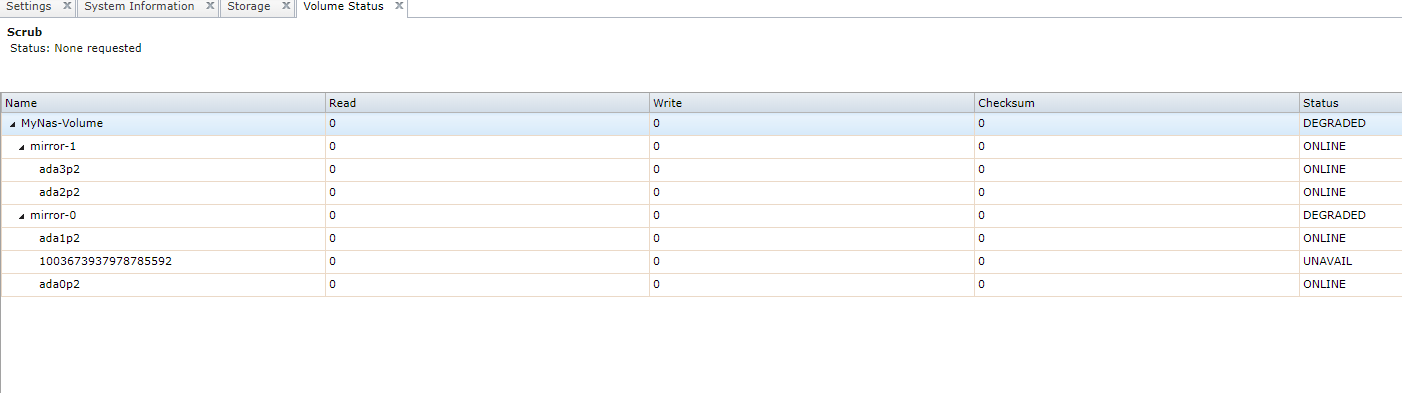

Hi everyone, i followed the steps above but the resilering process didn't start.
As you can see on the image the new hard disk is ada1p2 but the old one 1003673937978785592 is still there.
Have i done something wrong and what am i doing now?
Something that i have just noticed is that the status of the disk that i want to replace is "unavailable".
Thanks
