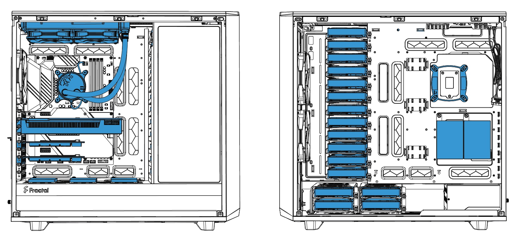

Looking at the layout of the Fractal case there with it fully loaded with 16 drives, I'd also want you to ensure you've got all four of the front fan spots populated. The image seems to imply that there's good spacing between the drives so you might not need high-pressure (and therefore higher-noise) fans up top, but the lowest four drives are much cozier. Keep an eye on them for sure.
Thumbnail below - click to expand.
The challenge with Fractal's cases are the drive mounts in combination with their positioning.
The bottom of the drive is covered, which in itself is similar to usual rack-mount cases. But since the drives are mounted such that the airflow comes from the side (and not the front, like in normal server cases) there is less airflow (roughly half) of what the drives would get in a rack-mount case.
I like Fractal's cases, but if you are after a silent multi-disk server case, I would look somewhere else. Depending on personal taste for HDD temperature, the OP will likely need high-pressure fans. For "reference", to keep my 8 disks under 40 degrees Celsius in the basement, I run 2 Noctua "NF-A14 industrialPPC -3000 PWM" and they are loud as hell. My old 1U Supermicro rack-mount servers (X9 generation) are much quieter under low to medium load.
Again, this is not to say that the Fractal case is a bad choice. But cooling that many drives, when they are packed so densely, is a challenge.
Personally, I have been looking for an alternative on and off, but never really found one. So if someone can recommend a sort-of quiet case for 8 drives, I would be thrilled :smile: .
Sorry for offtopic posting, but You asked for it. :wink:
For 3.5" (up to 8 and eventually 10, but those extra 2 wouldn't be hit by direct air flow): Fractal Design R5.
Had that case for 4 years. It was very nice, quite big, though. But I switched to 2.5", since the power draw was way to high for my applications (mainly 24/7 backup).
For 2.5" (up to 10 and eventually 16, but those extra 6 wouldn't be hit by direct air flow): LianLi PC-Q25 (or M25 for more PCI slots).
Both virtually silent (I know, "silence", sound and frequencies are highly subjective categories). For me it were just the drives humming with the case right beneath my desk.
After experimenting with a SilverStone CS-280 (in my opinion not that good for spinning rust due to bad air flow, but excellent for all flash) I am running the Q25 here @home and the 10 2.5" drives within barely hit 38 degrees Celsius. Base temp idle is 32-34 degrees Celsius. Absolute peak tests - replicating using plzip compression while scrubbing while "smashing" the NAS with concurrent backups via SMB and NFS - raised the disk temps to 43-45 degrees Celsius in hot summer. (They drop back to 36-38 once the scrub is done.)
140mm Front fan @ 800rpm, 120mm top fan @ 700 rpm, 92mm cpu fan 1000 rpm, 92mm psu exhaust fan in auto mode (never audibly spins up).
Beware: No matter what case i used, I never kept the factory fans and always switched to beQuiet silentwings or noctuas.
