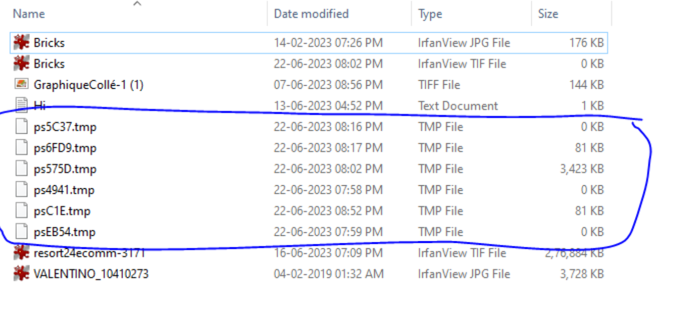

@Davvo @anodos I have upgraded OS to 13.0-U5.1
It seems still the same issue appearing. When someone opens a file it generates a few tmp and while saving any random file gets deleted. I suspect is it getting conflict with this .tmp file and generating issues.
Here is an example. Could you please suggest something on this ? I am clueless ....
You'll have to narrow down the application generating the .tmp files.

@Davvo @anodos
What you can do to help us help you is to patiently describe in detail your system and your workflow since it might shine some light on the issue.
I would guess to be photoshop.

Thanks for the reply. I have set up a few Truenas with 13.0-U5.1 version.
There are members who keep their data on these servers and work.
As per the above-given screenshot, as per project requirements. They keep images in a folder and work from that particular folder at the same time.
sometimes, random files get deleted. In log (unlink) it shows the user has deleted the file but at that moment in some cases, we found the user wasn't on the desk and the system was on lock mode (weird but we did check with the time stamp of the file delete / unlink log of server and CCTV footage - just checked whether human error or system). All the members are working on photoshop and working on certain types of images within the same folder. It came across that at the same place when people working on file it generates some .tmp files and I suspect it may be conflict with name and file getting deleted. Although, I have already enabled the .recycled folder, but the user has to find it in all the folders because it is usually found in a random folder of .recycled folder.

Sorry but I'm confused here. Can you be extremely specific with some file names that are being deleted? All I've seen so far is you point out .tmp files which is normal to have the program (Adobe Photoshop) create and delete them, typically shortly after the program closes, but if the program is still active (left open even though the screen is locked), Photoshop could still be deleting those .tmp files. Are you using "Adobe Photoshop"? I don't want to assume anything but I'm pretty sure that is what you are saying, plus the .tmp file names starting with "ps", but assumptions get people into trouble.
TrueNAS will not delete your files. That would make for a very poor file server and everyone would have heard about that kind of problem.
