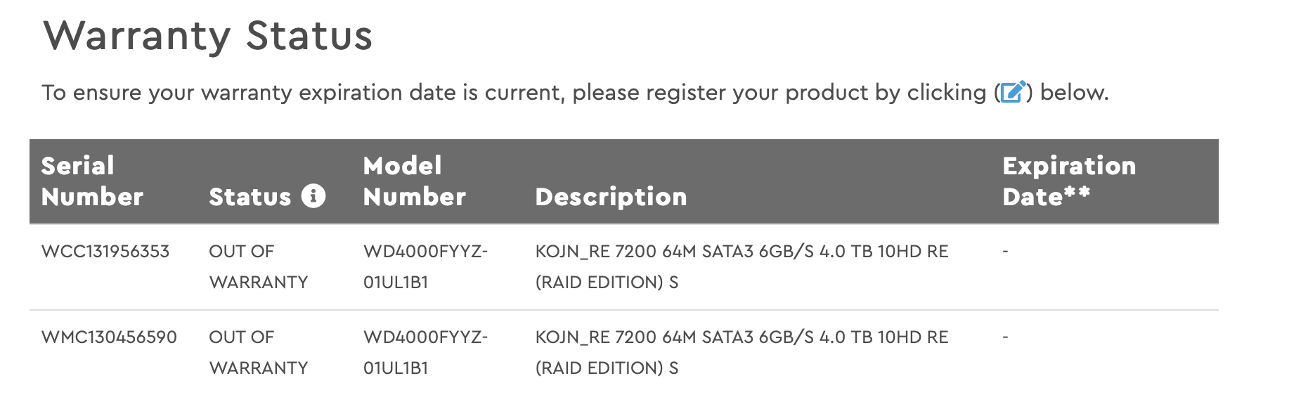

Looks like both drives are failing extended smart test.
You can confirm by repeating the extended test again. Can take 2-4 hours to complete, unless it fails quickly.
smartctl -t long /dev/da2
smartctl -t long /dev/da6
Looks like they are out of warranty

Jun 2, 2019
591
@zapcw
You are showing the results of two completely different serial number drives
Original drives with errors
WCC131956353
WMC130456590
Second post drives with no errors
WMC130395744
WMC130468246
I think you are getting your drives mixed up. Do not assume the /dev/da[n] will stay in the same order when you move drives between slots, or even follow the physical slot numbering. That order will get shuffled around based on your SATA controller bus enumeration and which bays are populated.
You still have two bad drives in your system that need to be replaced.

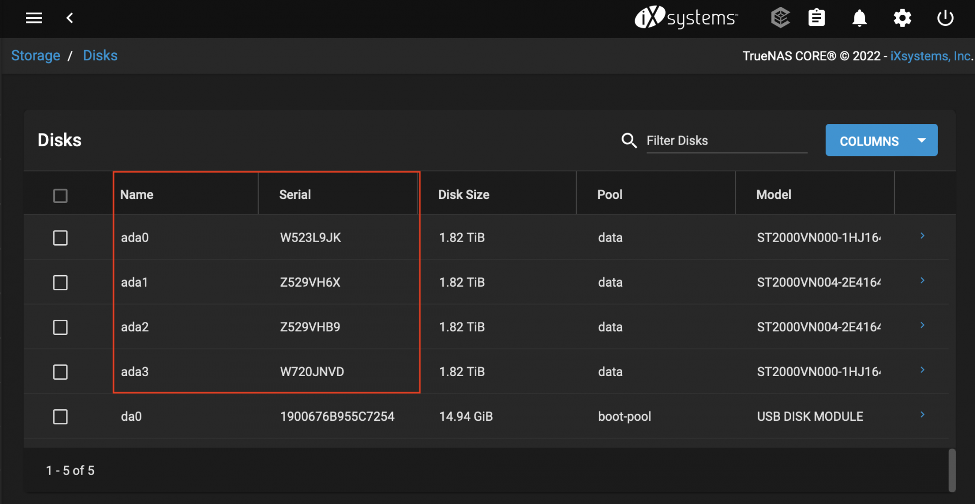

I suggest you make the disk serial number visible on your disk list.
