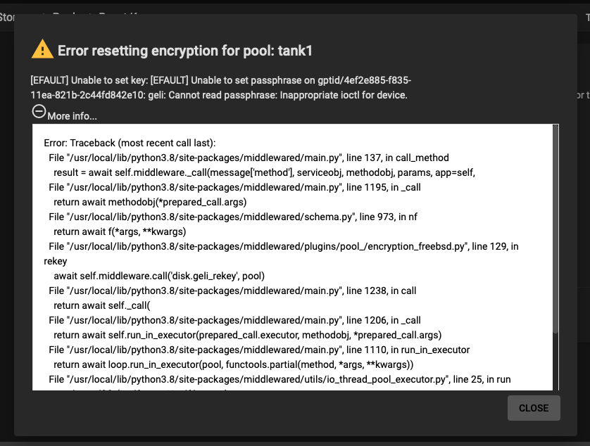

Upgraded to TrueNas from 11.2. Drive encryption has gone whack. If I try and extend the pool I get passphrase request. Entered my normal passphrase, didn't work. So I've tried to reset the keys. I'm in a jam...
Error Message:
  File "/usr/local/lib/python3.8/site-packages/middlewared/main.py", line 137, in call_method
    result = await self.middleware._call(message['method'], serviceobj, methodobj, params, app=self,
  File "/usr/local/lib/python3.8/site-packages/middlewared/main.py", line 1195, in _call
  File "/usr/local/lib/python3.8/site-packages/middlewared/schema.py", line 973, in nf
  File "/usr/local/lib/python3.8/site-packages/middlewared/plugins/pool_/encryption_freebsd.py", line 129, in rekey
    await self.middleware.call('disk.geli_rekey', pool)
  File "/usr/local/lib/python3.8/site-packages/middlewared/main.py", line 1238, in call
    return await self._call(
  File "/usr/local/lib/python3.8/site-packages/middlewared/main.py", line 1206, in _call
  File "/usr/local/lib/python3.8/site-packages/middlewared/main.py", line 1110, in run_in_executor
  File "/usr/local/lib/python3.8/site-packages/middlewared/utils/io_thread_pool_executor.py", line 25, in run
  File "/usr/local/lib/python3.8/site-packages/middlewared/plugins/disk_/encryption_freebsd.py", line 159, in geli_rekey
    raise CallError(f'Unable to set key: {error}')
middlewared.service_exception.CallError: [EFAULT] Unable to set key: [EFAULT] Unable to set passphrase on gptid/4ef2e885-f835-11ea-821b-2c44fd842e10: geli: Cannot read passphrase: Inappropriate ioctl for device.

You'll have to reboot back into 11.2, if you've not upgraded your ZFS version yet, to expand your pool. TrueNAS 12 no longer allows GELI operations, only native ZFS encryption.
