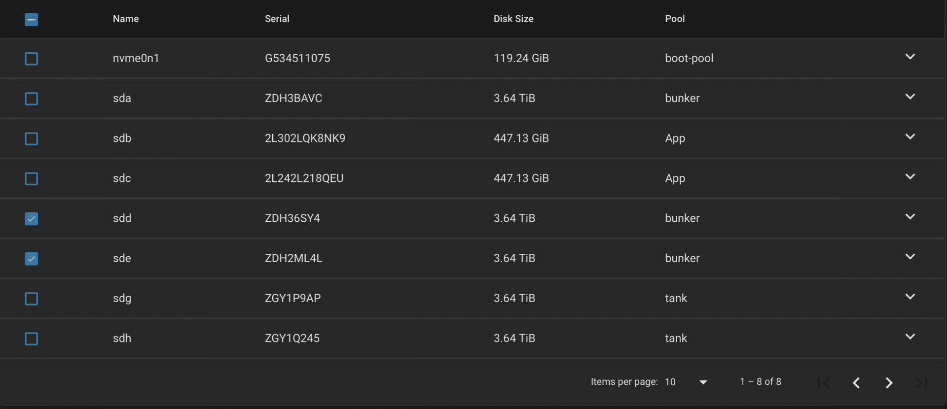

shit, just shut NAS down
I have 2 pools
Bunker, 3wide RaidZ1,
1 GOOD / dev/sda
1 HDD throwing errors /dev/sdd - SMART shows 0
1 HDD throwing errors /dev/sde - SMART shows 2
Tank, 3wide RaidZ1,
Degraded to 2 HDD's
/dev/sdg
/dev/sdh
/dev/sdf - EJECTED
See attached:
PoA.
As much as tank is degraded to 2 HDD's, it seem to be stable... where as Bunker is concerning,
Thinking is to replace the HDD's of Bunker first, then relocate the dataset that sits on Tank atm to Bunker, and then rebuild Tank with the good 4TB HDD's.
G

9,700
Tank, 3wide RaidZ1,
Degraded to 2 HDD's
/dev/sdg
/dev/sdh
/dev/sdf - EJECTED
That's not a pool of 2 disks, that's a pool of 3 with one missing (needs replacement).
Just follow the replacement process for the missing disk (should be an option in the GUI to replace and select the disk to use for that).
