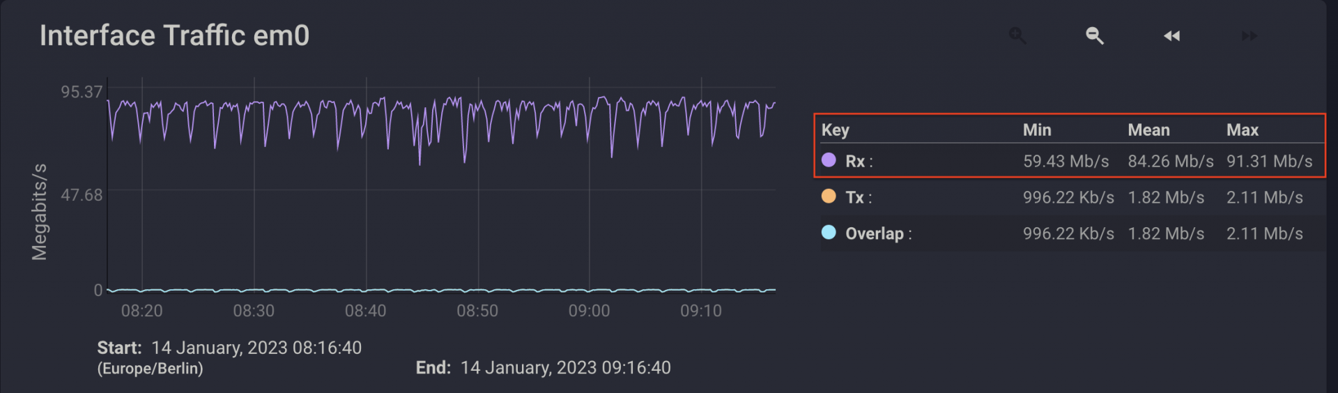

three virtual HDs 50/900/900 GB (physical 4 old HDs), in TrueNAS the 900GB HDs are mirrored. So far so good, the network speed looks
very good (s.screenshot)

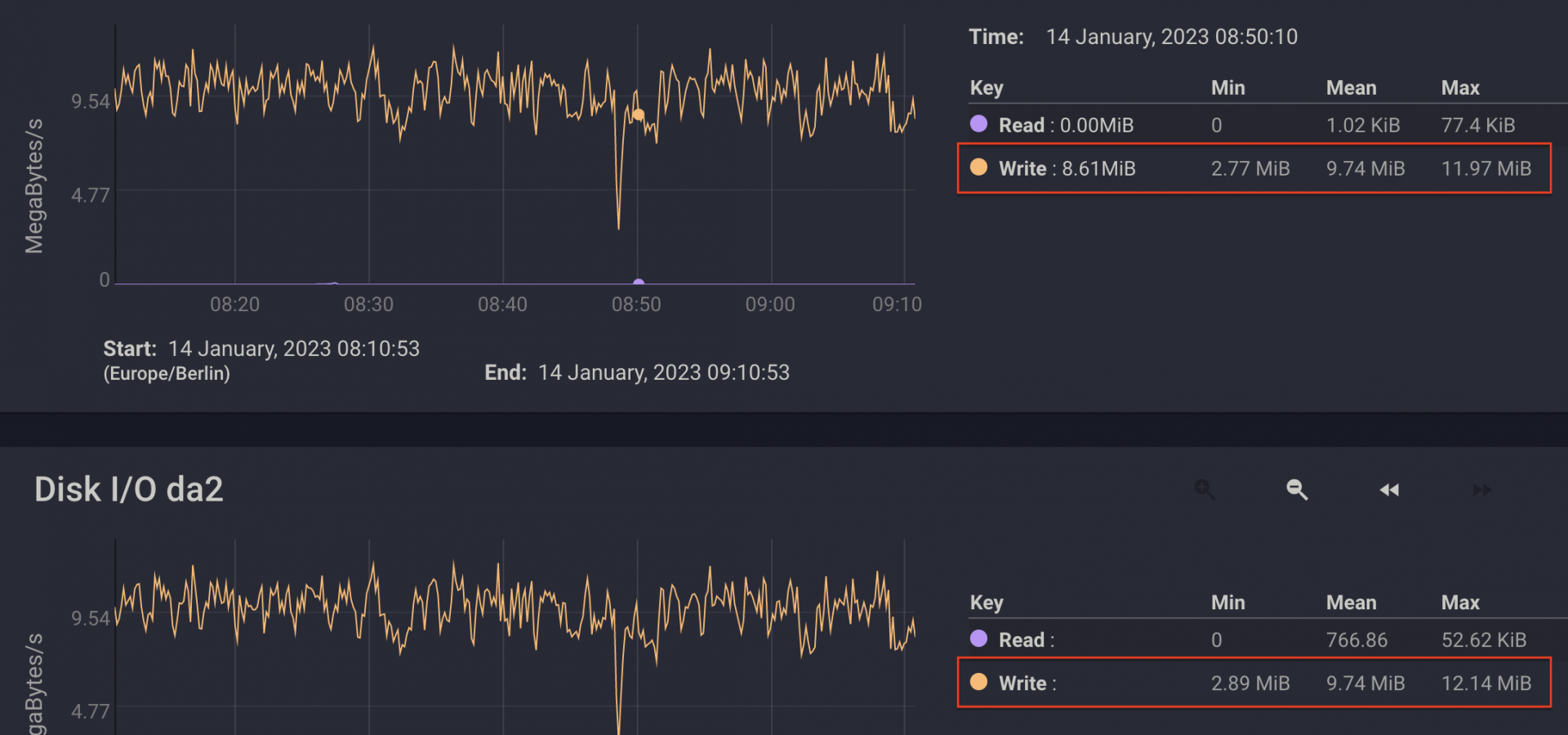

but the disks write speed is awful low:

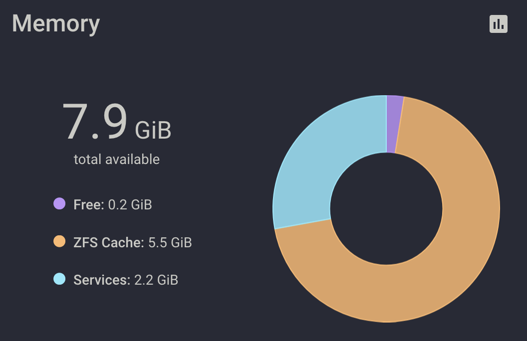

It is pretty obvious, that the bottleneck is the disk, but I have no idea what I can do to improve the performance. The ZFS memory consumption seems pretty aggressiv.

The lan interface is in Megabits/second and the drives are in MegaBytes/second so it looks about right.

Ups, you are right, I totally overlooked the different units Thank you,
