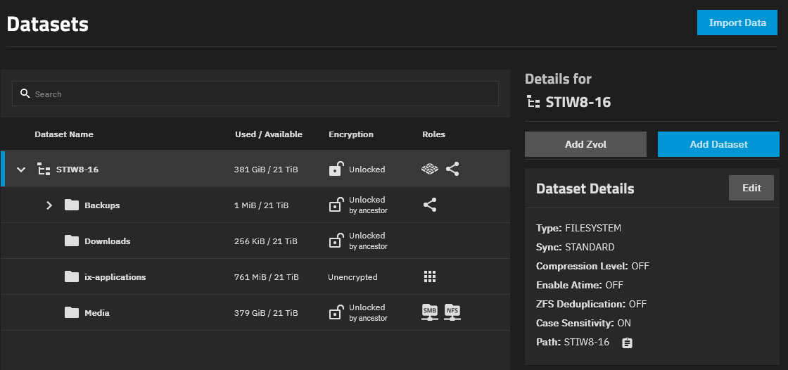

Hi, I'm a noob to TrueNAS and just set it up. So far I'm pretty disappointed in the performance but there's a good chance of misconfiguration on my side, hopefully.
I did trawl the forum and websites for infos quite a bit and found similar threads but the solutions didn't help me so far. At this point it feels like I'm just wasting time because I'm not exactly sure what I'm looking for. Maybe there's something obviously wrong to an experienced eye...
I think my setup is fairly straight forward:

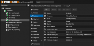

- Supermicro X10SDV-TP8F (XEON D-1518)

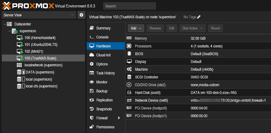

- Proxmox 8.0.3 Host (on SSD)
- VM for TrueNAS Scale (latest version) with 4 cores and 32GB RAM
- Broadcom SAS3008 Controller HBA (IT mode), pass-through to VM
- 4x 8TB Seagate IronWolf in a VDEV: 1 x RAIDZ1 | 4 wide | 7.28 TiB
- Main Dataset with Media sub dataset and SMB share
- Compression turned off
- Dedupe off
I'm not running apps or VMs within TrueNAS, it's just storage. My issues are copy & write speed through SMB (haven't tried anything else):
a) TrueNAS SMB share mounted on Synology DS214+ (DSM7)

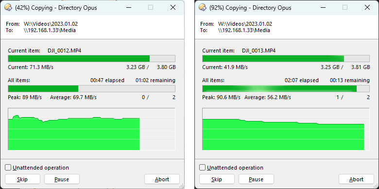

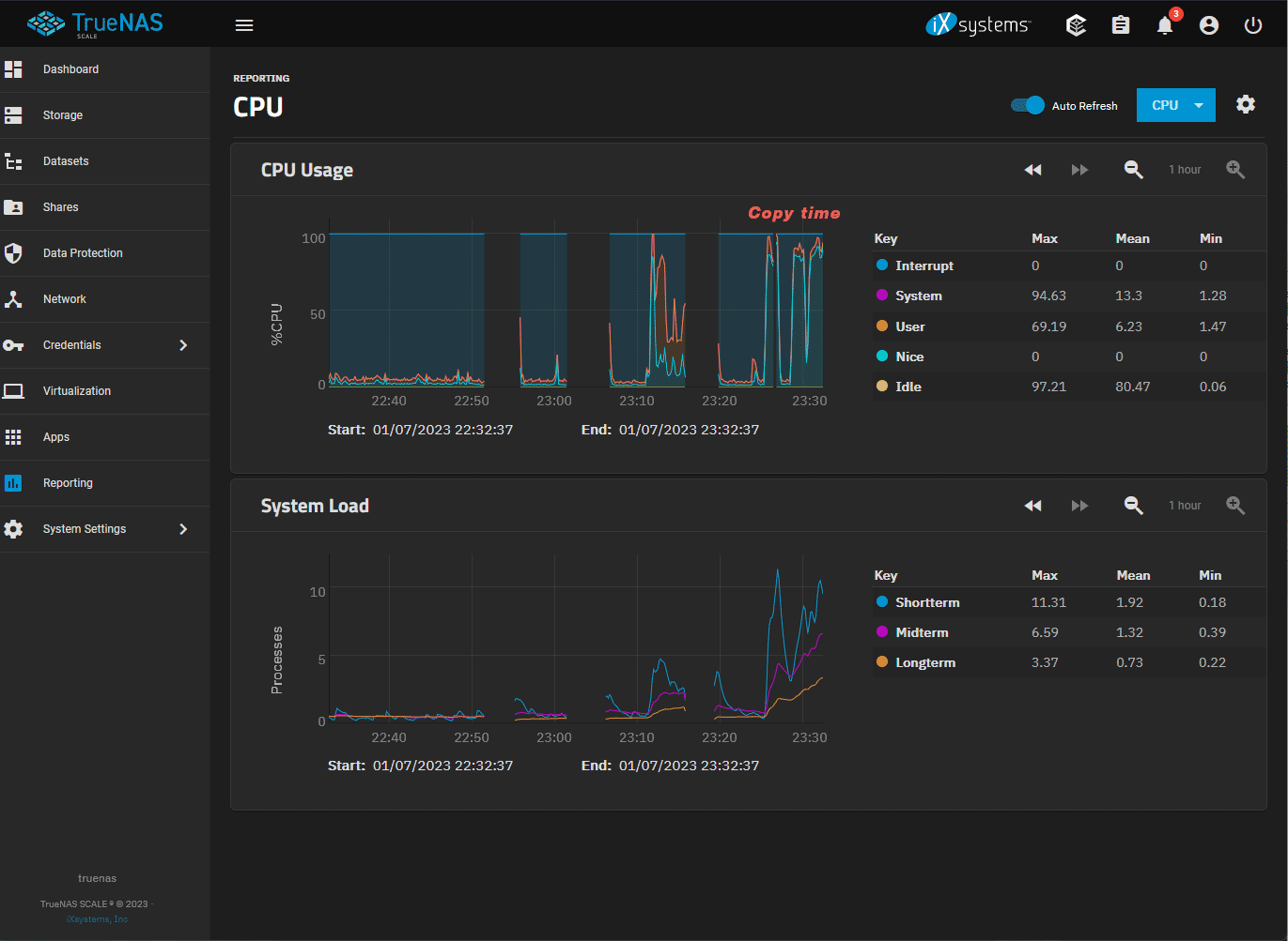

Copy large video files 3+ GB to TrueNAS starts as at expected 70-100 MB/s but drops down to 1/3 after approx 2-3GB and stays low, CPU shoots up to 100%.

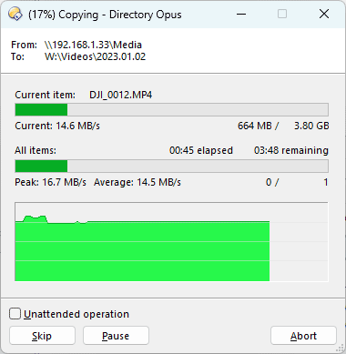

b) Copying the same file back from TrueNAS to Synology only does 10-15MB/s from the beginning!
c) Copying PC > Synology via SMB steady 80-100 MB/s
d) Copying Synology > PC via SMB steady 80-100 MB/s
So, it's not the PC and not the Synology I would say, it's something on the TrueNAS system. Even though the Xeon D-1518 is a bit older, it should easily match my old DS214+ Synology which doesn't have any speed issues.
I've attached some screenshots. Help would be much appreciated.

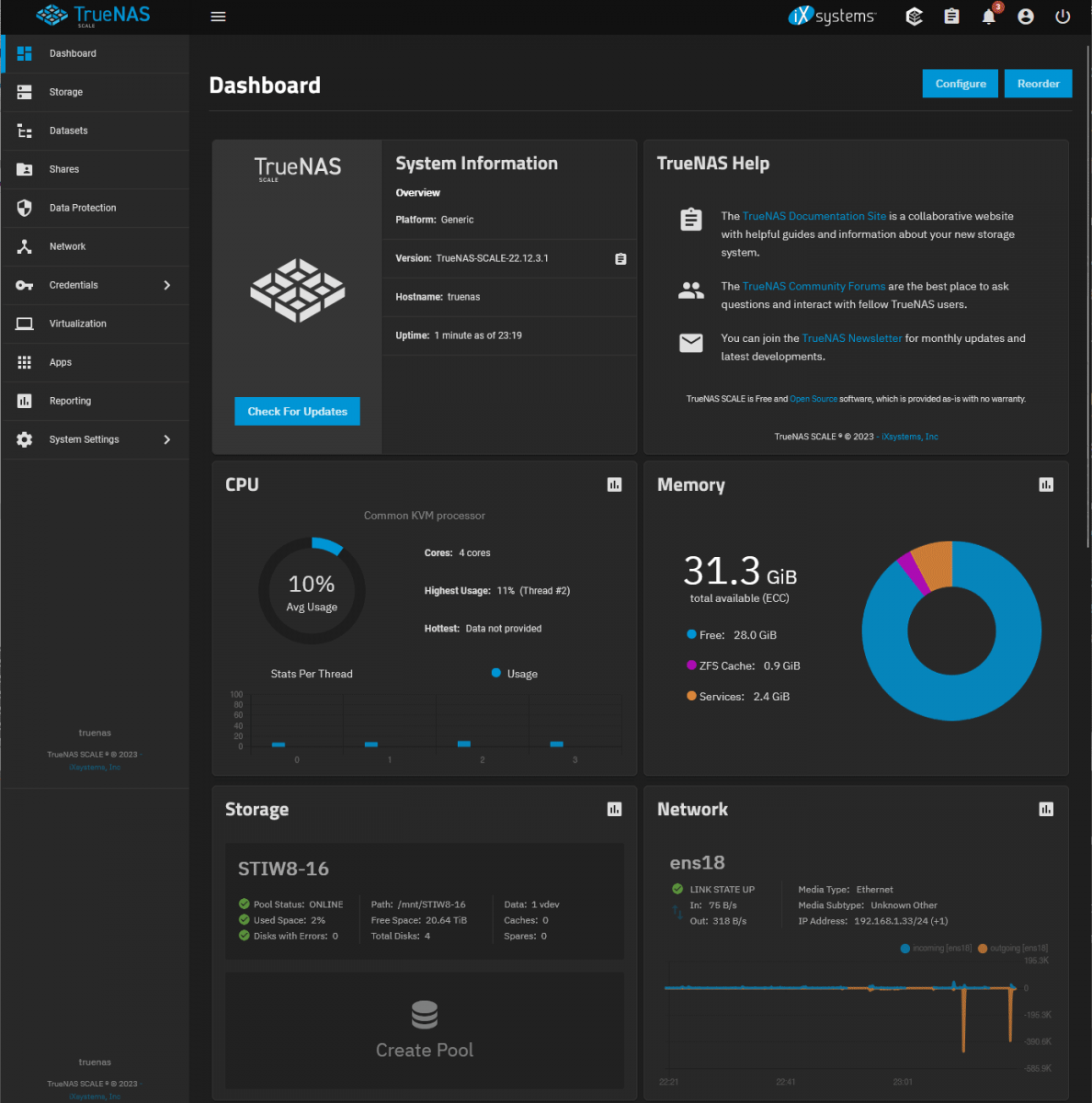

and especially focus on the "start on bare metal" advice. Your choice of a relatively underpowered D-1518 platform along with Proxmox, which isn't recommended, means you are fighting several simultaneous battles. It is not only possible to under-resource your NAS VM, but it is also possible to over-resource your NAS VM, and having the comparison to bare metal performance is very helpful to help judge how much of the CPU your workload should actually consume. Your workload may be swamping the 1518, especially with issues such as compression, which can be taxing on low-end CPU's (the D-1518 is a 2.2GHz part), you're using virtio for reasons you haven't explained, and your ARC performance as shown looks pretty crappy. Why the heck are you using SCALE, anyways? If you are just doing pure storage, SCALE is a horrible platform to be on. The Linux stuff is a bit dicey, especially its memory interactions with ZFS.
The Synology is not comparable to a ZFS system. I believe the Syno typically does BTRFS or EXT3, neither of which are particularly stressy. ZFS does checksumming, compression, and RAIDZ computations on the CPU, and Samba is quite CPU-demanding and is expected not to perform particularly well on your low speed CPU. It's why I typically like to encourage people to use something fast, like an E5-1650 v3, which offers a lot more elbow room.

Instead of Scale try Core. Core is the more mature, stable and performance tuned version of Truenas. Core is the base for iX enterprise customers.
Scale is in it's first release cycle and currently has to fight some zfs on linux limitations regarding ARC (50% Limitation). Core is the battle proven veteran for pure storage needs. If you dont need the apps system or the scale out functionality give core a try.

First tests are promising. Same VM hardware setting, pool settings, but running TrueNAS Core 13.0-U5.1
Copy SMB from Win11 to TrueNAS (3x 3GB files) continuously 95-98 MB/s, CPU max. 60% (4 cores), RAM max 33% used.
Copy back from TrueNAS to Win11, continuously ~105 MB/s, less CPU usage.
I'll get my 10GbE adapter for my PC later this week and see how much throughput I get. Is there a benchmark how much roughly 4x 8TB IronWolf can deliver in a RaidZ (read/write)?
