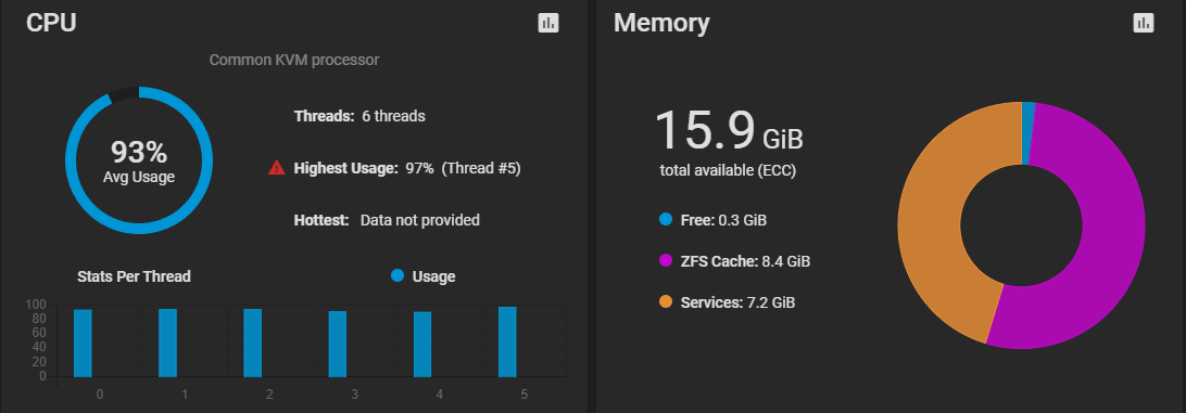

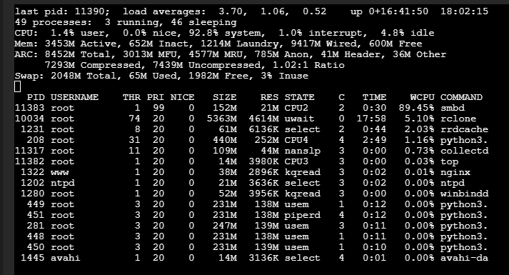

Hello all,
I setup 4x4 tb drives in raidz2 at my system:
asrock b560m-itx/ac
i3 10100
32 GB RAM
Delock 5 port SATA PCI Express x4 Card
4x WD Red Plus 4 TB
+ SSDs for proxmox and backup of VMs
Truenas as VM
and I assigend 6 cores and 16 GB RAM to Truenas. When I copy files I hit almost 100% usage on all 6 cores during the transfer (via a SMB Share from a Windows Client).
On a live dataset I had the compression set to ZTSD, then changed it to LZ4 - no change and then to compression off. Still the CPU load is that high during transfers.
Any ideas where I can look what may not be configured properly? The documentation states "TrueNAS does not require two cores, as most halfway-modern 64-bit CPUs likely already have at least two." hence I believe such high system loads are not to be expected.

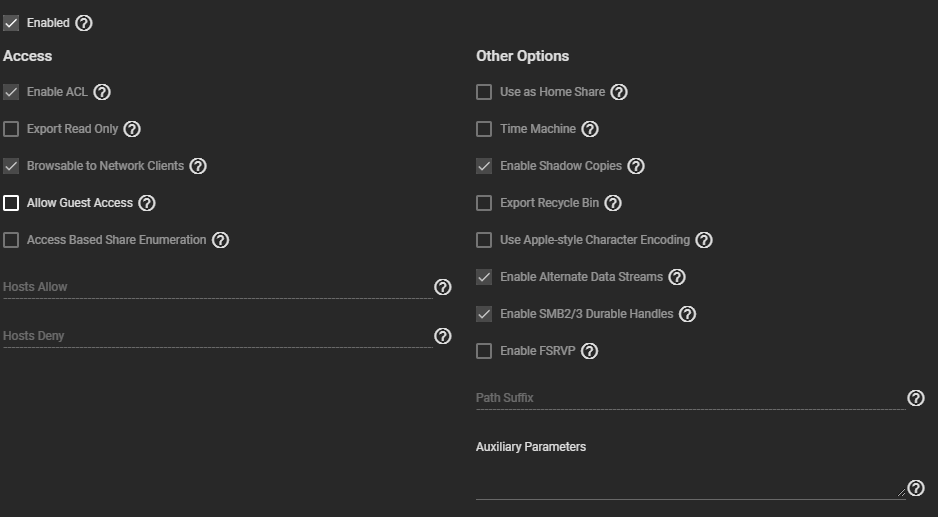

edit: added screenshots for further information
Thanks in advance!

Originally the VM had 4 cores and 12 GB RAM and when I saw that all four cores are at 100% I added two and some RAM.
The CPU has hyper threading, at first I thought I couldn't assign more than 4 cores but 4 cores at 100 % from truenas corresponded to around 50% load for the proxmox server.

@HoneyBadger I changed to two cores and allocated even more RAM:
2 cores running almost at 100 % equal around a quarter of CPU load, hence I think I could assign 8 cores. But that's not too important since none of my applications are really CPU intensive and that many cores anyway. Apparantly except for truenas.
