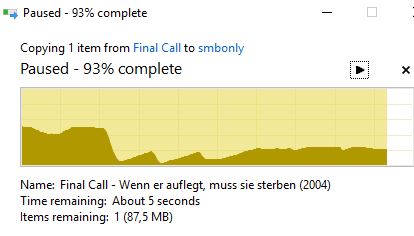

Up to now I used Win 2012 Server VM as my Backup destination / mediaserver and so on. Now I want to try TrueNAS on ESXi as my central storage. Beside the TrueNAS VM, there are some different small VMs (on one more different SSD). Performance is one of my goals, as I dont know why with Server2012 I sometimes I get 110MB/s copy speed, sometimes only 60 MB/s. So I will give TrueNas a try. At the end I will buy two new disks, and will configure them as a mirror in TrueNas , mybe I will move also my Nextcloud as Plugin to this VM - IF tests of performance is ok (I would expect 100 MB/s for large files, as I have seen this on this configuration). Unfortunately at the moment it is absolut not.
TrueNAS got 8 GB RAM, 2 vCPUs, SSD for OS, 2 VMDKs as DataStorage (HDDs, but for testing also a SSD)
Unfortunately the speed is poor. If I copy from one VM to TrueNAS Share (SMB, different physical disks!), It got speed between 100MB and 2 MB/s in one copy. It is fluctuating - you can see it in the screenshot. Dedup / Compression is switched off. Its much slower, as using my Windows Share, where I get at least flat 60 MB/s.
Something what I did really wrong?
