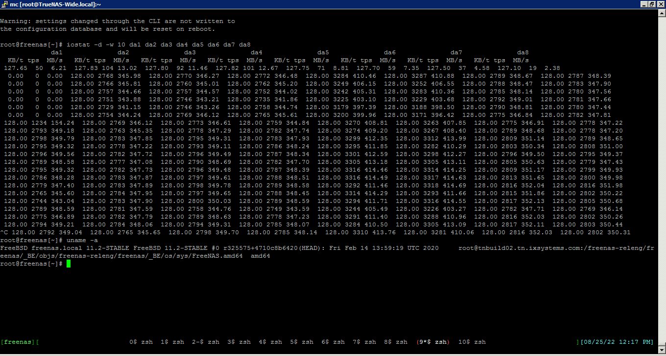

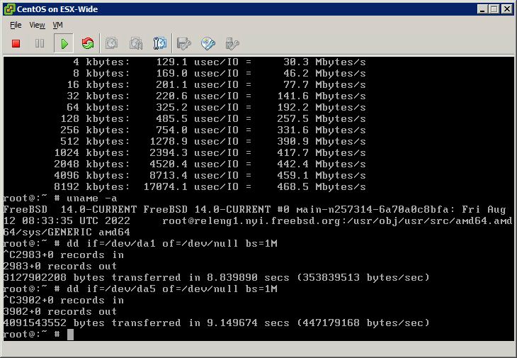

And test results now it changed.
ESXi or hardware configuration did not change from earlier today
I reloaded TrueNAS 12.0U8.1 VM I started testing with (In-TrueNAS-Wide_short_tn12_orig-fw.txt)
VM's configuration did not change (only zpool was offline because other systems changed data on disks), however results are as follows:
root@TrueNAS-Wide[~]# dd if=/dev/da1 of=/dev/null bs=1M
15216934912 bytes transferred in 33.545648 secs (453618744 bytes/sec)
root@TrueNAS-Wide[~]# dd if=/dev/da5 of=/dev/null bs=1M
15879634944 bytes transferred in 33.056925 secs (480372420 bytes/sec)
No FreeBSD -based VMs shown this level of performance on this system yet
This level of performance persist after restart and zpool recreation
Its still slower then in CentOS but not as drastically.

I did not notice that log until I checked log files later.
Did another test today, with 3 disks, errors repeated for each of them.
Errors began ~5minutes into 2nd solnet's "initial parallel seek-stress array read"
~an hour into stress-test my SSH connection to this TrueNAS dropped. May not be related but ssh did not drop to ESXi and to another TrueNAS on another ESXi sitting next to this one. SSH did not drop during previous tests too.
Full 1st test log and corresponding part of /var/log/messages attached.
Appreciating any help/insight
