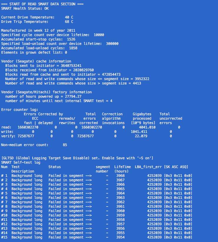

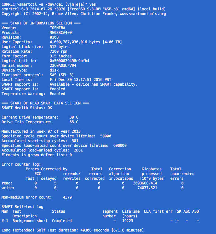

Here is an example on a system that I did a fresh install about 6 hours ago (see image New Install 9.3)
And here is a better example of what Im talking about with a system that has been running for a longer period of time that I have updated and is currently on 9.10.1-U4 (see image System 2....).
As you can see, both systems have run either a background long or short test but NEITHER are actually Scheduled (no SMART tests in Tasks)...

What I would like to know is if I don't actually schedule SMART test, but the service is on and my disks support it, when do these test run?
All this means is the OS will check the SMART data, basically the SMART Health Status. This is self-run basic testing while the drive runs such as checking the drive electronics and then any write/read failures. This is not conveyance, short, or long testing. You should read up on what SMART is to fully understand it. Basically if you wait for a SMART reported failure without running routine SMART tests then you can expect the drive to warn you of a catestrophic failure that has already happened or will happen in 24 hours or less.
SMART short and long tests run in the background by nature but must be commanded to run, they will not run automatically and if you find one that actually does run automatically, I'd like to know about it because that would be something worth investigating.
When you post data like SMART outputs, please post all of the data, it feels like we are missing quite a bit here. I'm not sure why you took an image vice taking the text abnd pasting it. You obviously have a failing drive in System 2 9.10-1U4.
But for some reason, I have gotten SMART notifications via email from time to time with ZERO WebGUI scheduled tasks.
That is becasue your drive has failed.
So I see you having two problems right now:
  1. You have a hard drive failure which you need to identify and replace.
  2. You need to setup routine SMART Short and Long tests.
If you need help with the failing drive, in my signature is a guide I made to help people with hard drive troubleshooting.
I'd recommend you setup daily short tests and weekly long tests.
