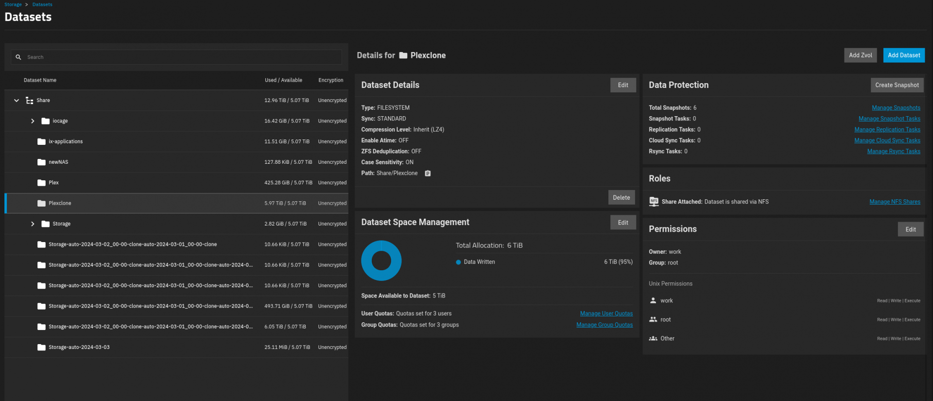

DELETE PLEX. I had restored all of my missing data just to see it disappear again once I enabled plex. I am very unhappy again. Now if I could get Jellyfin to work, just gives me circles when trying to add libraries.

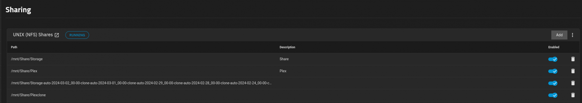

I am trying to copy my data from the last snapshots I setup as share but now I am getting an error while trying to mound the shares
mount.nfs: access denied by server while mounting
Odd thing though, I can mount my file share and the permissions for each share are the same.

Did you make changes to the allowed hosts and networks on your NFS share?
Don't make this harder on you than it needs to be. Use SMB if NFS doesn't work, just to get your data back.

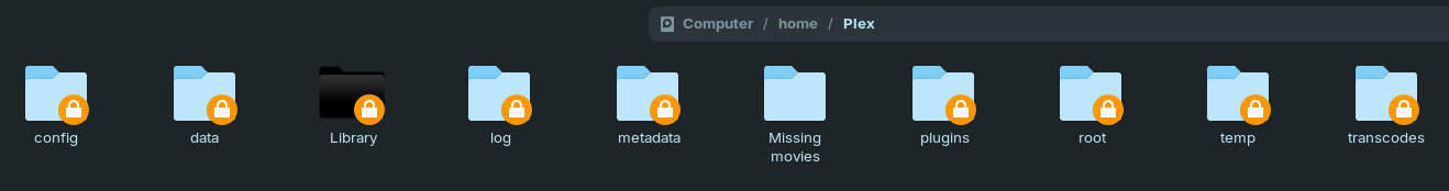

I put my media in the right directory. Thanks for the hostpath validation suggestion. I will look into it.
I am an idiot, I did not share the new dataset I created with a new snapshot. Ooops.

Whay are you sharing the plex folder? It's not something that should be exposed; iirc in SCALE (similarly to CORE) you have to set a dataset for your apps: are you using the /pool dataset as the apps' dataset? That might be the issue.
opensourceFTW
May 27, 2022
86
I shared the plex folder because I was adding media. Plus plex was giving me errors, would not allow me to add my own library. I deleted plex, I will try to use Jellyfin.
Davvo
Jul 12, 2022
3,222
It is suggested against keeping other files besides the app's ones inside the app's folder; instead, it's suggested to have a separate dataset (which can be shared) for ie the library.
This is true for emby, plex, jellyfin, nextcloud, everything.
