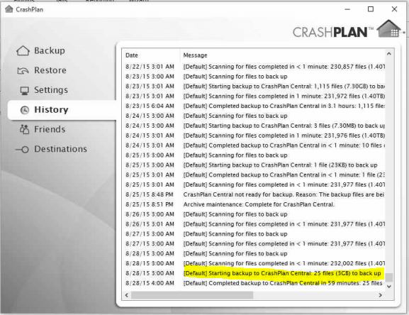

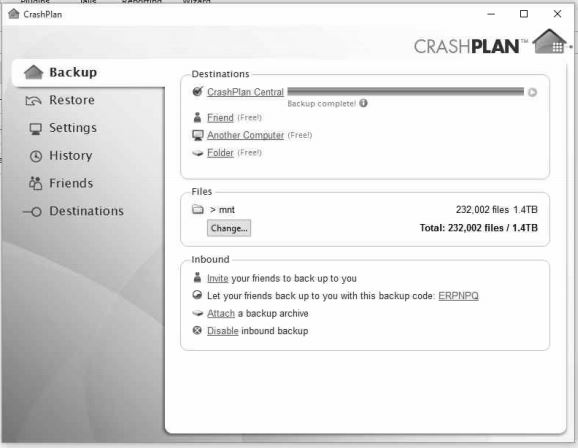

Andrew076
Apr 5, 2015
206
nevermind. looks like my issues are more towards the .ui_info wanting to keep changing! Same with the my.service.xml information even when both changed and saved in conjunction. Once the jail is restart or the NAS restarts it all changes and needs to be changed again
And can someone let me know how crashplan on my windows computer is supposed to look? When I log in it always defaults to my windows workstation
I am not 100% sure what you mean, but this is how it looks for me when I login on Windows. Crash Plan.JPG
Then when I check the History log to be sure it is working...
If you have other questions let me know and I will post more screen grabs for you.
