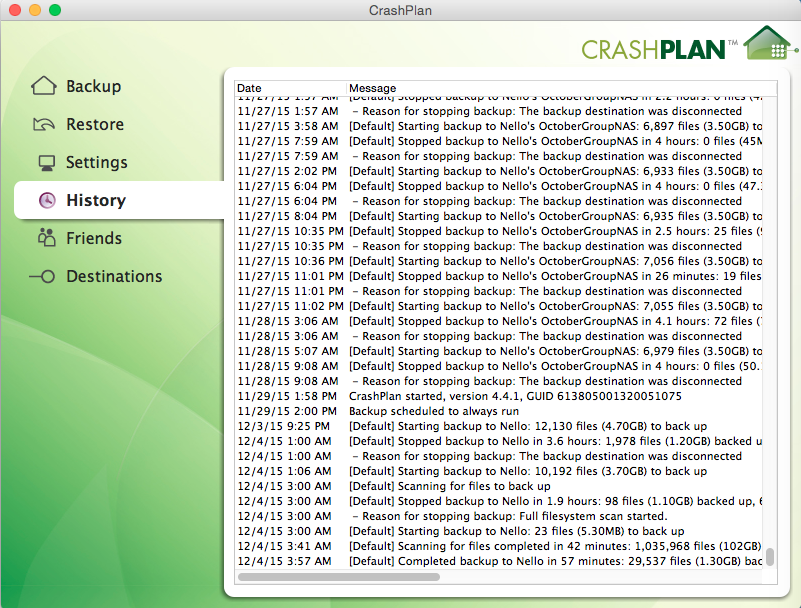

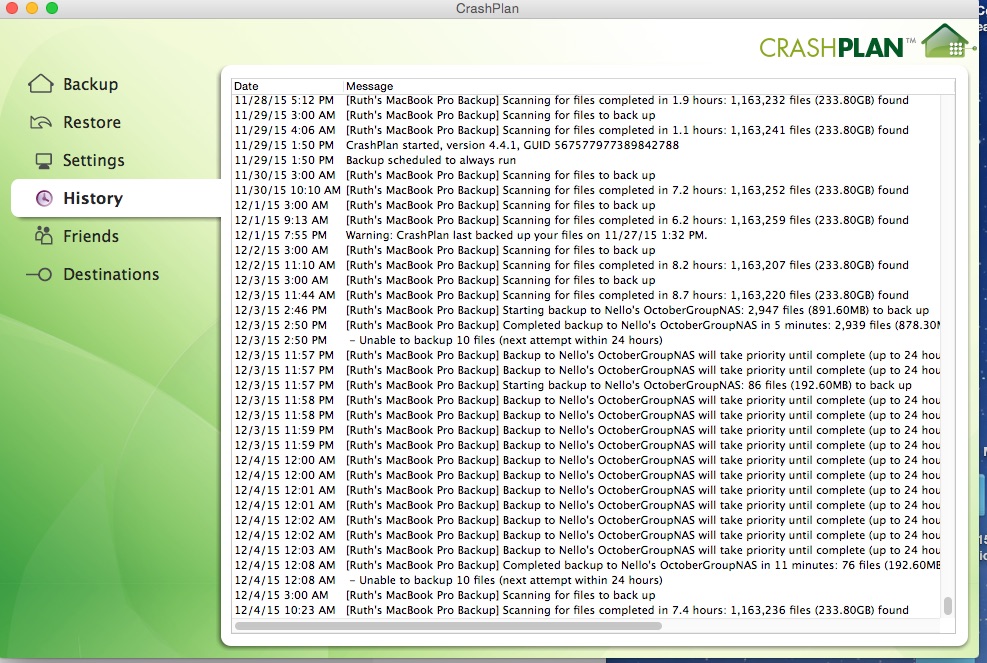

UPDATE 2015.12.06
After reviewing CrashPlan logs for both WAN and LAN Macintosh clients, I see now that all these clients were connecting and backing up to my FreeNAS server. Please accept my apology for posting this red herring.

UPDATE 2015.12.06
