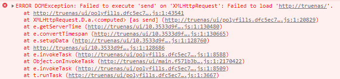

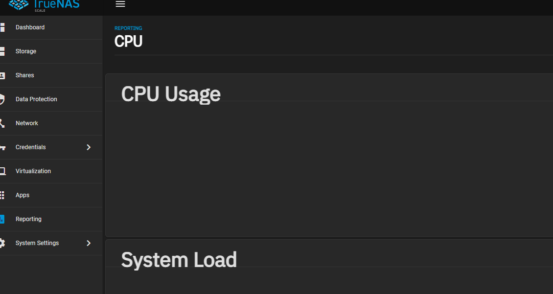

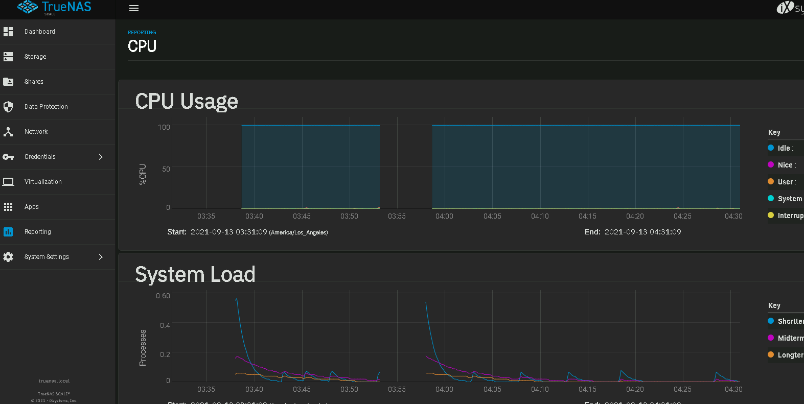

I don't know if it this is the same bug...
Here is my problem (TrueNAS Scale 21.08 Beta and TrueNAS Core 12.0-U5.1):
If I access truenas via the ip like https://192.168.1.57/ui/dashboard and click on "CPU Reports" icon, I get the graphs displayed correctly.
But if I access the same report via my proxied domain like https://myserver.com/reportsdashboard/cpu the graphs are not shown:
any idea?
thx
