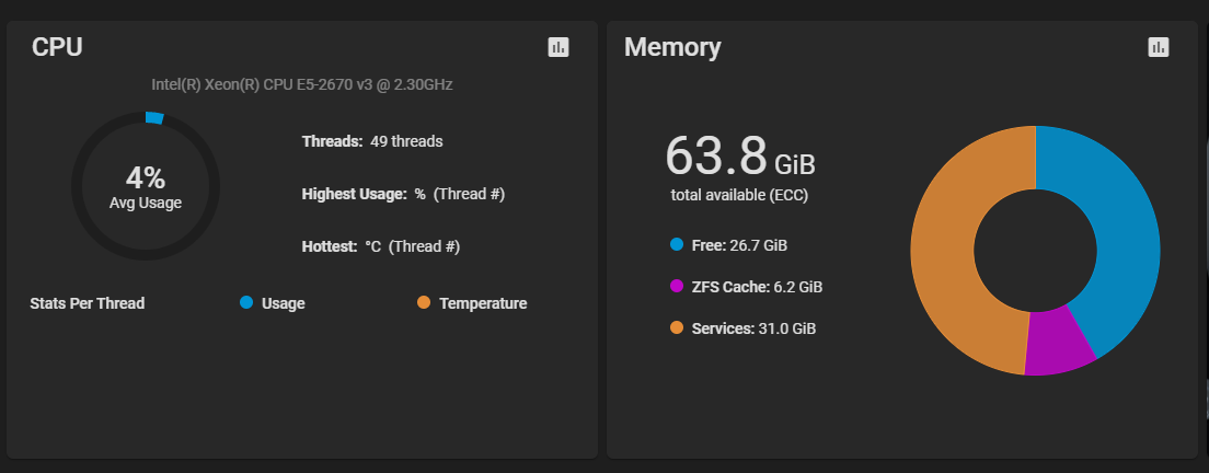

Seriously though, doesn't look like the dashboard is updating. Utilization % remains constant, obviously no per thread util or temp readings are displayed... and 49 threads?? Doesn't look like RAM usage is changing as well.

I did a hex compare of the patch file posted on reddit and it seems to apply the first commit but not the second. Maybe this would be sufficient in the interim. I am waiting for any developers' updates next week. Hopefully we do not have to wait until August for this fix when U5 is scheduled to be released.
EDIT: Changed my mind, installed the patched file after verifying the patched region, and it works fine. It may not be a perfect or final fix, but it does the job for now. The file posted on reddit included an additional byte at the end which does not seem necessary, so I removed that. I am attaching this version here. If you decide to try it, I suggest that you rename the original file in case you want to revert the patch.
EDIT 2: Given some are having issues installing this, here are the steps:
  1. Unzip the archive and transfer main.7827c30e6733c013d061.js.patched to /usr/local/www/webui (this should be a BINARY transfer)
  2. Rename original file: mv main.7827c30e6733c013d061.js main.7827c30e6733c013d061.js.orig
  3. Rename patch: mv main.7827c30e6733c013d061.js.patched main.7827c30e6733c013d061.js
  • main.7827c30e6733c013d061.js.patched.zip
jlpellet
Mar 21, 2012
287
Checked bug tracker earlier today & it shows resolved to be addressed in U5, currently scheduled for early August.
9,700
The fix posted by @revengineer works and doesn't need a reboot.
The CPU status on the dashboard is a "nice to have", so you should weigh-up the real need and implement the temporary fix if you really can't live without it.
