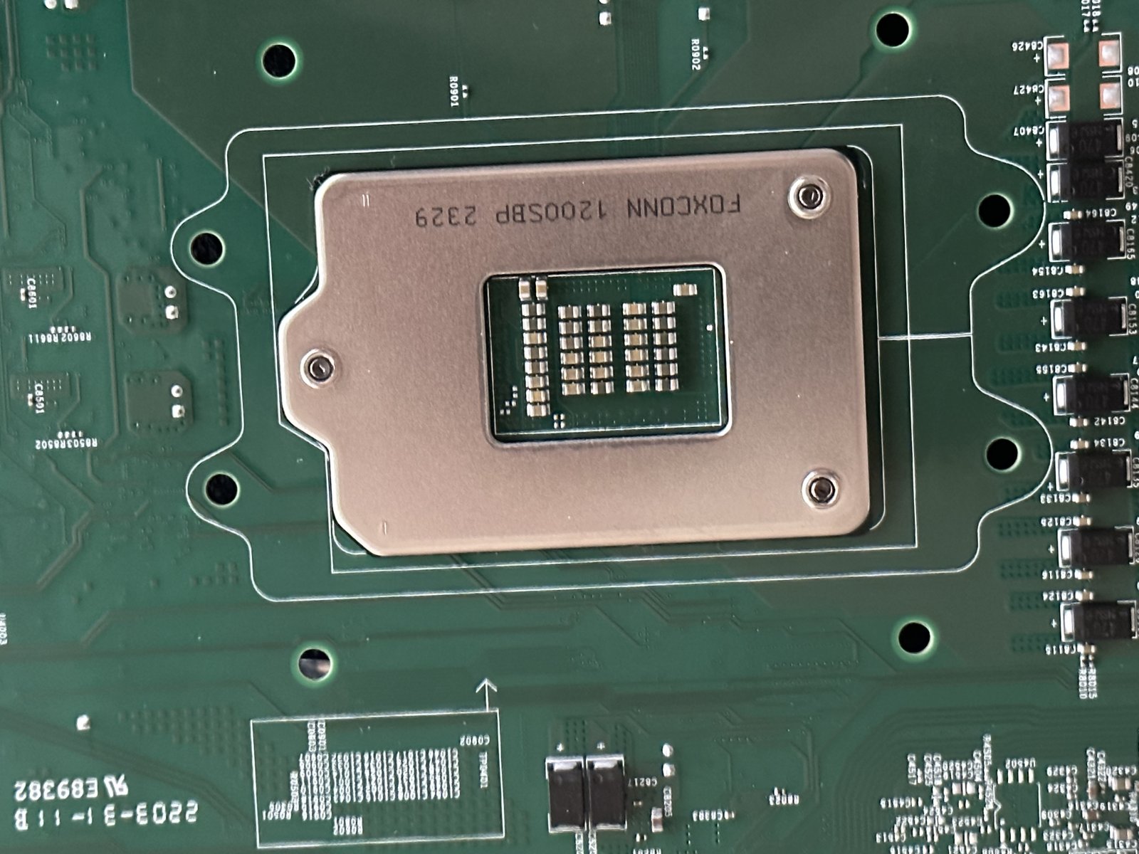

The thing that's in the way is likely the backplate glued on the motherboard.
I think you're right. That's a great link -- thank you!

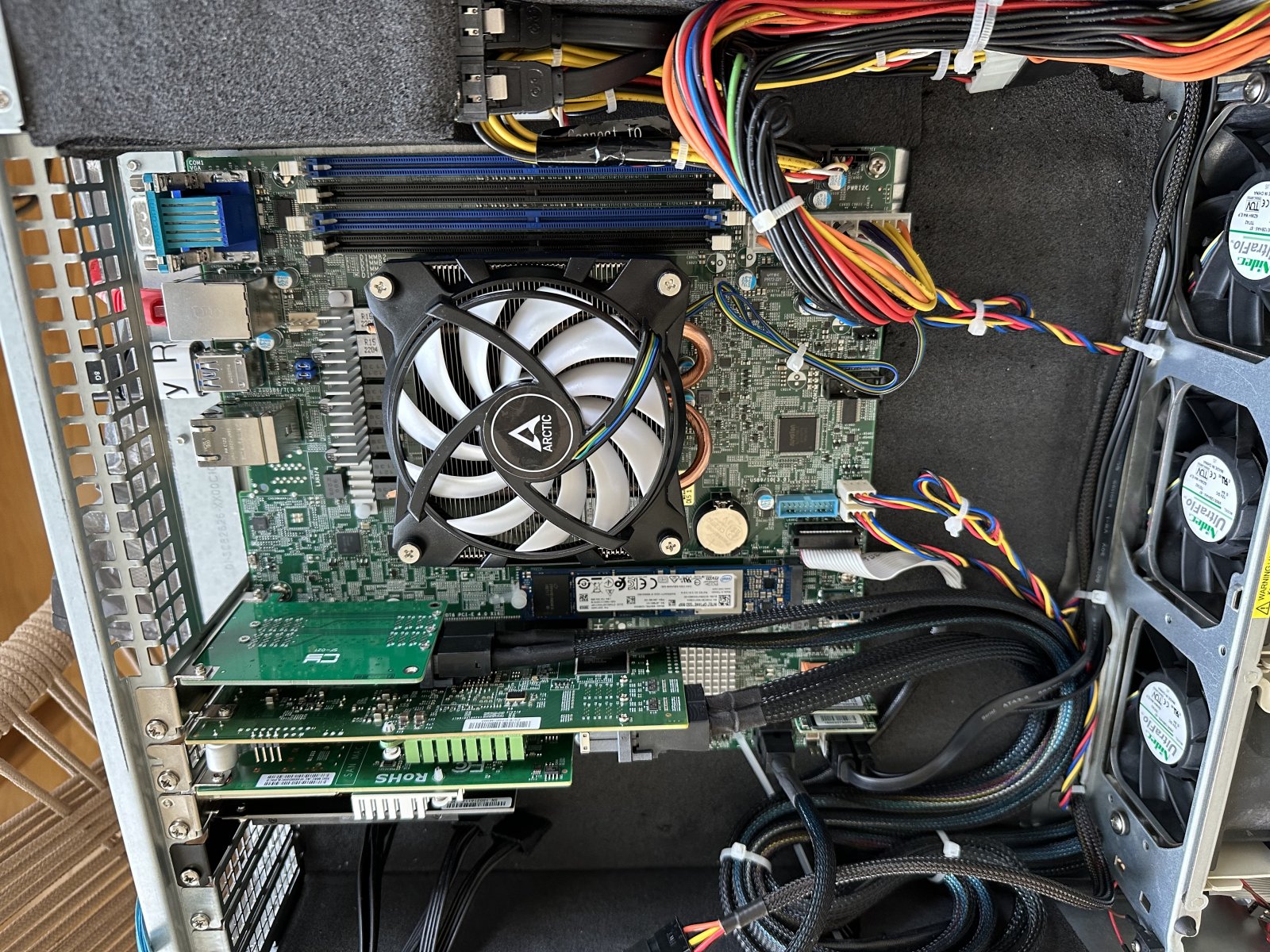

For those who might find this thread by search, the Supermicro X12STH-F motherboard has a backplate, but it's not usable for attaching the CPU heat sink. Rather, it has the open holes like one would expect on a consumer motherboard. The Supermicro-recommended passive heat sink (SNK-P0049P) needs a backplate and I did not find a Supermicro part number for that. So, I ordered a generic consumer backplate for the LGA-1200 (and LGA-115x) and we'll see if that works.
If it doesn't, there are some active heat sinks that look like they would work. Most likely is the Arctic Freezer 11 LP. It has a three-pin fan that uses its own sensor to determine fan speed -- it doesn't use the IPMI settings. Arctic calls it silent, so maybe it doesn't matter.
Otherwise, parts have been arriving all week. All the eBay & Amazon stuff came quickly -- the things I ordered from Newegg haven't been so fast -- still waiting on some that might not arrive before the end of the week. Not that I'm in a hurry...

Never seen that kind of backplate. It looks like you can install commercial coolers there.
That backplate looks like the CPU Socket backplate, not a CPU fan backplate. There are definitely holes many cooler types.
Yeah. I guess this combination of Xeon and pushpin holes adds some complexity. Several vendors, including Noctua, use reinforcement on the bottom of the board and the CPU backplate interferes with their solution. Anyway, the Arctic Freezer 11 LP arrived today and installed correctly.
