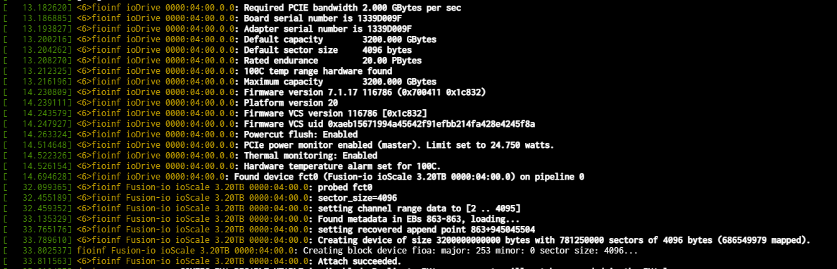

Personally i've installed driver for Fusion-IO flash card and it works stable with SCALE
Everytime i'm upgrading TrueNAS to newer version i have to install DKMS driver.
But yes for NIC it's lottery
NIC i use is Mellanox Connectx3 but TrueNAS itself uses virtualized NIC from ESXi 7.03
I have 2.5Gb nic based on Realtek Chip and i can connect it to TrueNAS Scale VM for testing :>
