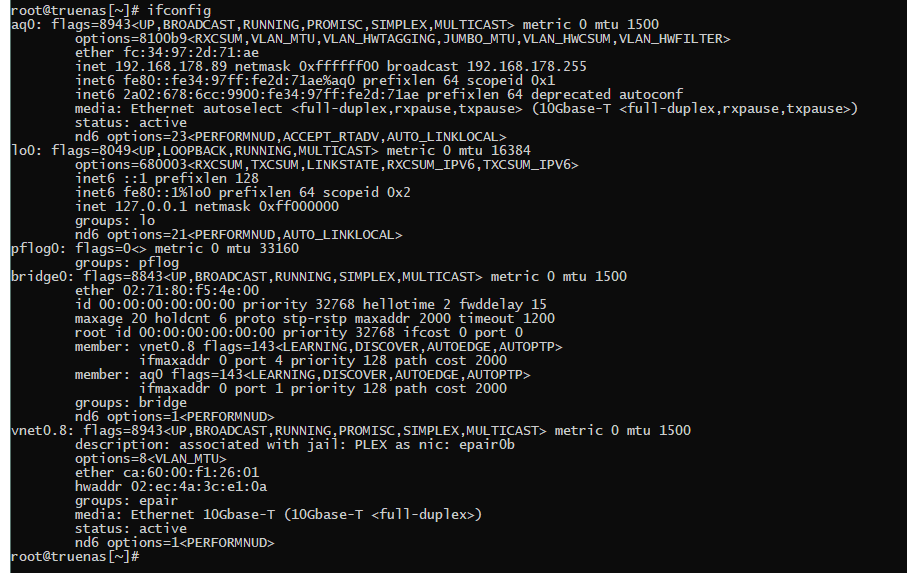

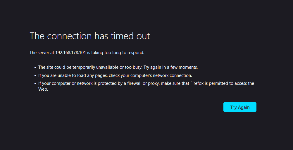

So I have the following problem. I'm unable to reach my web-interface via <host>:32400/web
My jail is setup as a VNET with a manual IP address 192.168.178.x is my entire network Router is 192.168.178.1
The Jail is running and used to work. The plugin is running inside the Jail. But ever since I switched from 1GbE (onboard LAN) to my new 10GbE (ASUS XG-C100C) And I can by the love of papa Jesus, not figure out why.
Pinging the server also doesn't work.

I mean the Samba works and iperf3 reports almost 10Gb/s. But yea VLAN... any tipss on how to CLI troubleshoot this?
Aaah, thought it was only the jail that had moved to 10Gbps :smile:
A simple test to figure out what's going on is to use tcpdump and check if the traffic gets handled by the interface (both in and out).
You might also want to check for any VLAN_* options set on the interface. Since the driver is quite new it might not behave properly with those options enabled.

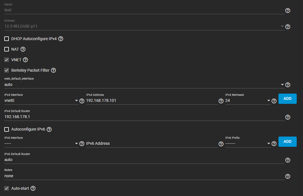

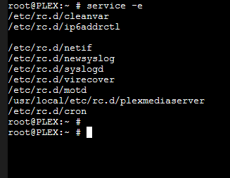

What if you make a new "test" jail for another Plex instance? (Just for the purpose of testing.) Are you able to access its Plex Web GUI?
Moulebutz
Jan 5, 2022
5
I tried, no luck. I even tried with NAT setting. Could it be a Plex issue?
