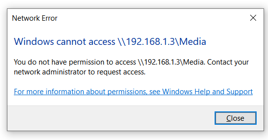

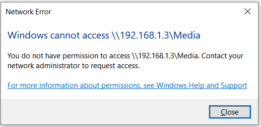

Hello all,
My N40L FreeNAS had sat idle for about 18 months I recently decided to upgrade the storage which went fine and I then copied data from my older 2TB [N36L] setup onto the larger combined unit.
I then discovered that the server no longer listed under Windows 10 Network [suspect this may of already been an issued but went unnoticed] although I could browse to the \\ip address but when attempting to access a share [I had one share as read only, and another separate which was writable]
In my attempts to troubleshoot the initial not listing under Network I have changed FN software versions to the latest build under a fresh install and found some gpedit to enabling guest access under win10 but suspect I have broken my permissions completely and am at a lost and would appreciate any assistance.
I have reverted to my last known working version as below but can move back to the newer build as require. I found that only the latest 11.3-BETA1 starting listing under windows network broswer again. But either I was requested to login - guest username with no password logged in but the permission issue remained.

Your permissions are wrong on /mnt/Media. They don't allow traversal. setfacl -m everyone@:rxaRc:fd:allow /mnt/Media. This will be easier in 11.3 with the ACL manager. We've also made it so that users are no longer permitted to alter the permissions / ACL on the root of a zpool (to prevent these sorts of problems).

I managed to reset a user account passing and then after broswing to the IP address directly was finally able to access my SAMBA shares as normal. Thanks for the assist.
