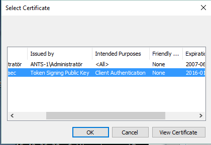

PS.PS. I'm still interesting why sometimes Window's Select Certificates dialog ask me when trying to connect to CIFS. I don't have the details when and why. Is this something related to SMB protocol 3.x version? DS.DS.
