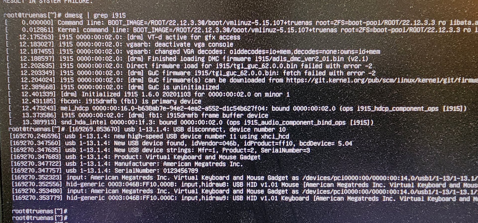

I would also like to know if anyone has this setup working. I have an Alder Lake CPU, a i5-12400, UHD 730 graphics, and when I run:
# dmesg | grep i915
I am getting these errors in the output:
i915 0000:00:02.0: Direct firmware load for i915/tgl_guc_62.0.0.bin failed with error -2
[drm] GuC firmware i915/tgl_guc_62.0.0.bin: fetch failed with error -2
[drm] GuC is uninitialized
Any feedback is greatly appreciated :)
Lipsum Ipsum
Aug 31, 2022
22
Can you please tell me if it is officially supported by the current PROD version of truenas scale (TrueNAS-22.12.3.3)
Officially supported? No
I mean using its iGPU for hardware transcoding on Plex and Nextcloud apps.
I don't use Plex and Nextcloud, but I do use Jellyfin. And I have hardware transcoding working.
Is there anybody here who actually using any Alder lake CPU (its iGPU) for hardware transcoding? If yes, was it working "out of the box", or you had to make some magic to get it working?
Yes, no not out of the box, but had to type some magic words to get it working.

cd /tmp
git clone --depth=1 https://git.kernel.org/pub/scm/linux/kernel/git/firmware/linux-firmware.git
sudo cp -rn /tmp/linux-firmware/i915 /usr/lib/firmware
The above should copy any updated firmware files into the i915 firmware directory without overwriting existing files.
sudo midclt call system.advanced.update '{"kernel_extra_options": "i915.force_probe=4680 i915.enable_guc=3"}'
Replace 4680 with your id as required. The parameter enable_guc=3 enables loading of both the HuC (HEVC encoding) and GuC (everything else) firmware.
sudo reboot
Reboot.
After rebooting and getting back to a command prompt, check dmesg again and see what the output is.
admin@truenas[~]$ sudo dmesg|grep i915
[ 0.000000] Command line: BOOT_IMAGE=/ROOT/22.12.3.3@/boot/vmlinuz-5.15.107+truenas root=ZFS=boot-pool/ROOT/22.12.3.3 ro libata.allow_tpm=1 amd_iommu=on iommu=pt kvm_amd.npt=1 kvm_amd.avic=1 intel_iommu=on zfsforce=1 nvme_core.multipath=N i915.force_probe=4680 i915.enable_guc=3
[ 0.027317] Kernel command line: BOOT_IMAGE=/ROOT/22.12.3.3@/boot/vmlinuz-5.15.107+truenas root=ZFS=boot-pool/ROOT/22.12.3.3 ro libata.allow_tpm=1 amd_iommu=on iommu=pt kvm_amd.npt=1 kvm_amd.avic=1 intel_iommu=on zfsforce=1 nvme_core.multipath=N i915.force_probe=4680 i915.enable_guc=3
[ 14.290352] i915 0000:00:02.0: [drm] VT-d active for gfx access
[ 14.292182] i915 0000:00:02.0: vgaarb: changed VGA decodes: olddecodes=io+mem,decodes=none:owns=io+mem
[ 14.293985] mei_hdcp 0000:00:16.0-b638ab7e-94e2-4ea2-a552-d1c54b627f04: bound 0000:00:02.0 (ops i915_hdcp_component_ops [i915])
[ 14.298424] i915 0000:00:02.0: [drm] Finished loading DMC firmware i915/adls_dmc_ver2_01.bin (v2.1)
[ 14.412852] i915 0000:00:02.0: [drm] GuC firmware i915/tgl_guc_62.0.0.bin version 62.0 submission:enabled
[ 14.412872] i915 0000:00:02.0: [drm] GuC SLPC: enabled
[ 14.412881] i915 0000:00:02.0: [drm] HuC firmware i915/tgl_huc_7.9.3.bin version 7.9 authenticated:yes
[ 14.414276] i915 0000:00:02.0: [drm] GuC RC: enabled
[ 14.416585] [drm] Initialized i915 1.6.0 20201103 for 0000:00:02.0 on minor 1
[ 14.418817] snd_hda_intel 0000:00:1f.3: bound 0000:00:02.0 (ops i915_audio_component_bind_ops [i915])
[ 14.419157] i915 0000:00:02.0: [drm] Cannot find any crtc or sizes
[ 14.420608] i915 0000:00:02.0: [drm] Cannot find any crtc or sizes
[ 14.421906] i915 0000:00:02.0: [drm] Cannot find any crtc or sizes
