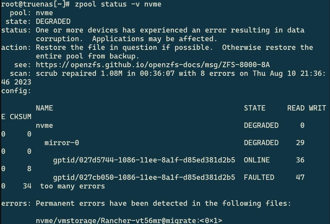

On my new TrueNAS Core 13.0_U5.3 server (disregard my signature system) I have a RAIDZ mirror of two Silicon Power P34A80 2TB NVME drives. I use this pool for iocage jails and a few VMs.

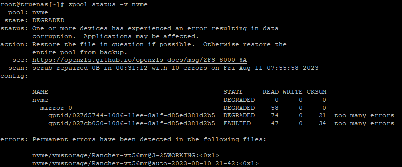

At first the zpool showed degraded and a zpool status -v on it showed this (screenshot from SSH on a phone):
I thought I could maybe fix this by deleting that snapshot so I did. Now after a scrub and another zpool status -v I'm getting this:
The drives are only a few months old, show nothing wrong in SMART and show no read errors issuing "nvmecontrol logpage -p 1 *drive*".
What is my path forward to correct this and take it out of a degraded state? Do I actually have to go as far as destroying the whole pool?

ZFS is trying to tell you that you have 2 problems...
CRC errors: possibly your disks are not well connected to the system. (difficult to troubleshoot in an M.2 type connection... how are they attached? PCIe converter in a slot?)
Read Errors: possibly related to the CRC errors in terms of root cause, but may independently be an issue. Can you get reporting out of SMART?
I would start by trying to see what's going on with the drives first... maybe temperature behind it all, frying the controllers?

The disks are connected directly to the M.2 slots on a Gigabyte X570S Aero G motherboard. I ran longtests with nvmecontrol as well as looking at the logpage for errors and nothing looked suspicious. If you or someone lets me know what command to run I can show the output here.
9,700
Can you get smartctl -a /dev/nvme0 to give output? (changing nvme0 to whatever is right for you)

Here is output of both of the drives in the mirror:

Here is -ax output from the drives
