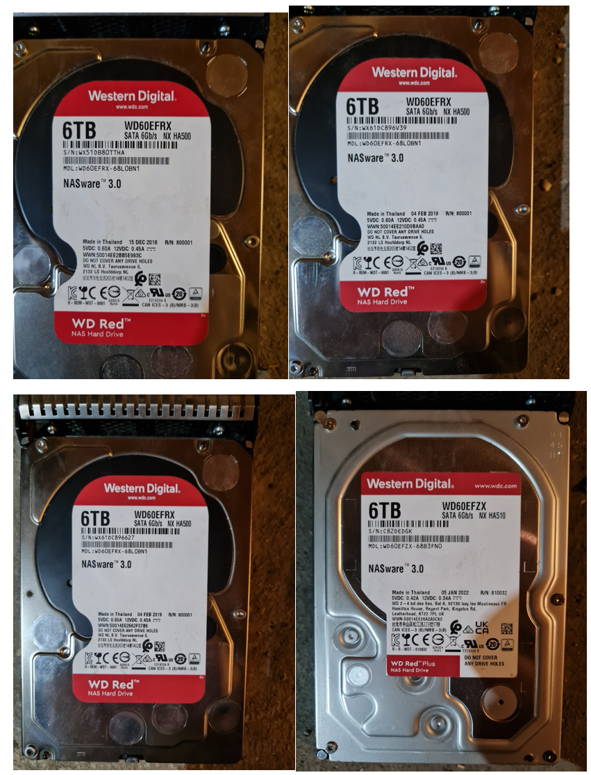

Also verified appropriate drives
So ordered two more, I guess they will be WD60EFRX.

Got the last two drives.
