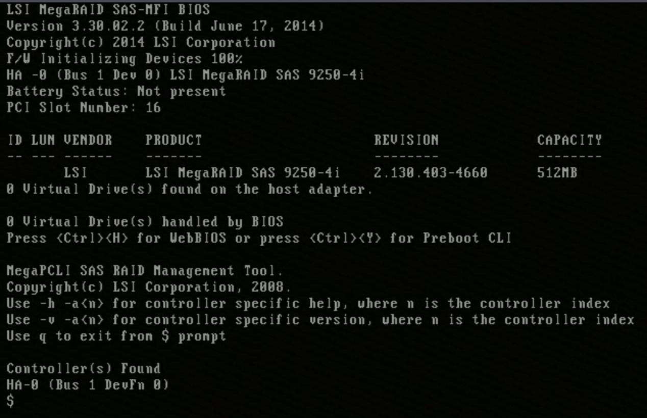

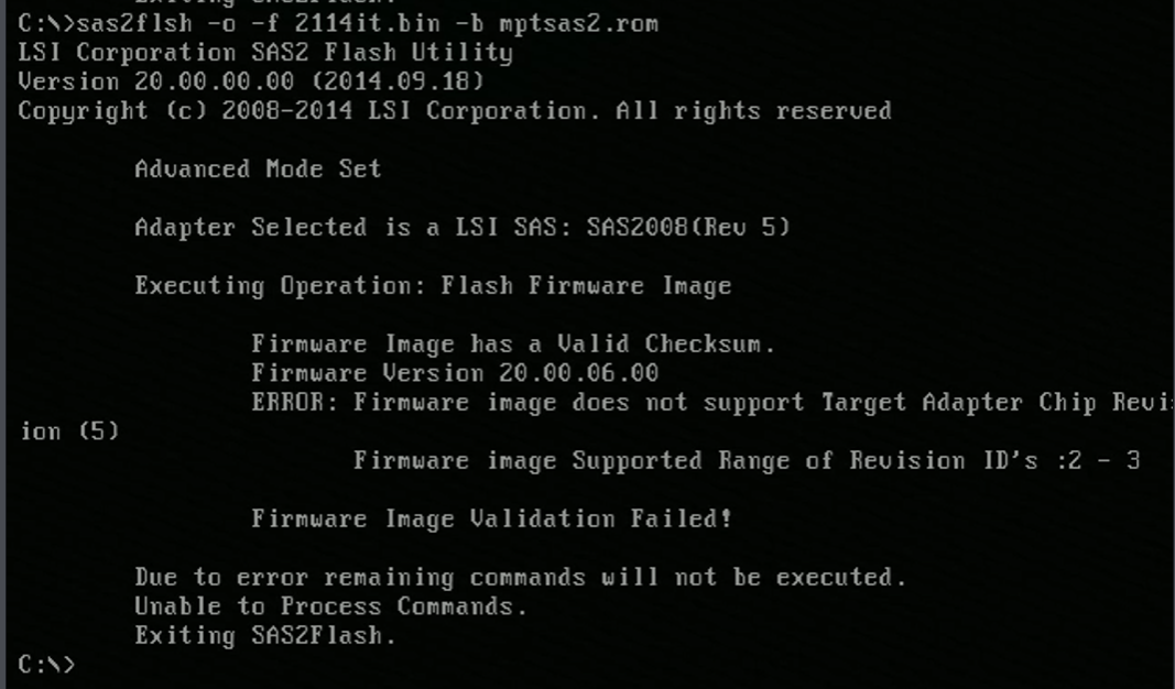

I happen to have a LSI 9250-4i card installed. Unfortunetly it seems not to be compatible with the 2114/2118 it mode image. Is there a compatible firmware for that card .. already tried my luck at broadcoms page ...
UPDATE: Ok .. so after digging deeper it seems the 9250 is (as the 9260) using the LSI SAS2108 chip and apperently there never was an IT mode for that specific one. I guess I am going to get an 9211 instead ...
Realistic answer: Get an SAS2008/2308
Craziness: Enterprising hackers have figured out how to load IT firmware on SAS2108 controllers, but the only widely-known method I've seen is for Dell cards only (and thus useful mostly to allow for the internal PCIe slot on Dell Gen 12 systems to be used with an HBA).
