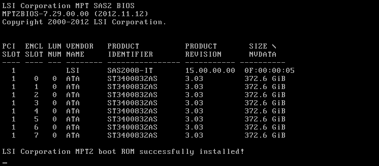

This is the BIOS probe of an M1015 in IT mode with 8 drives attached via a single SFF8087 and an LSI SAS expander (Supermicro 24-drive SAS backplane). Directly attached drives look just about the same, just fewer of them:

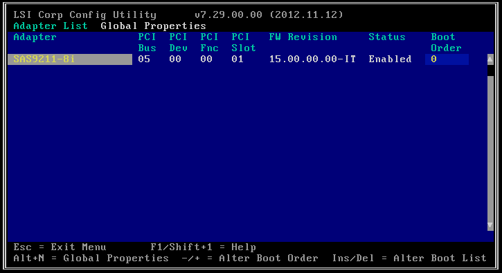

You can hit control-C during that to get to the card configuration utility.

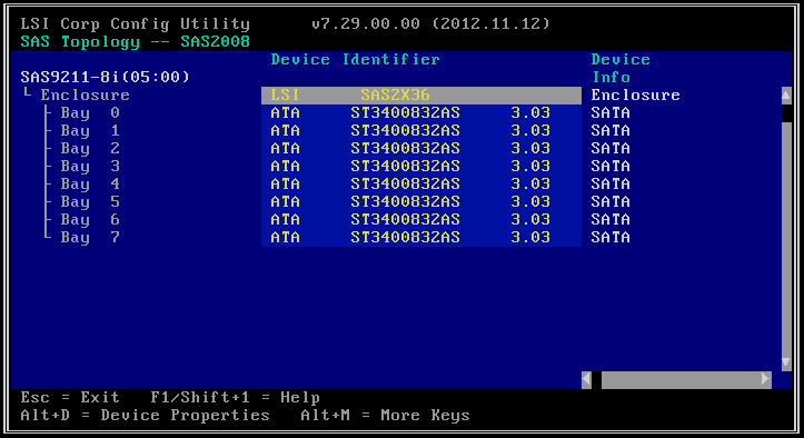

Shows you the adapter type and firmware revision. Note firmware version 15 and IT mode. You can look under SAS Topology at your attached disks, but really there's not a whole lot to be seen here in IT mode.

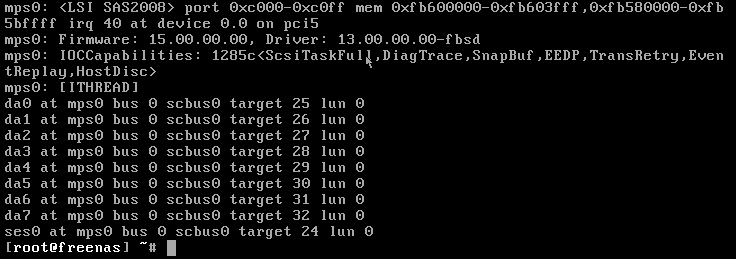

Within FreeBSD, that'll probe as a controller serviced by the mps driver, and the drives will appear as normal "daX" devices and appear in "camcontrol devlist", so pretty straightforward pleasure there. A "dmesg | grep mps" would show something like:

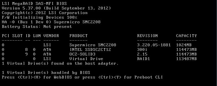

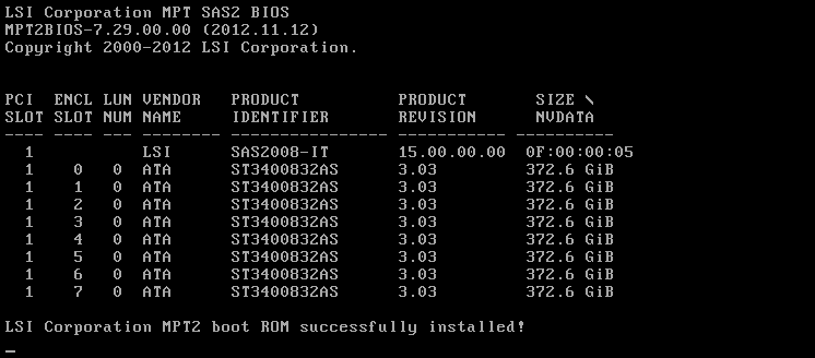

We have a Supermicro LSI 2208 built into the mainboard on this server. Planning to use it for ESXi so yes we needed a RAID controller, but right now it is running FreeNAS for fun testing. The "Driver for new LSI card" thread came across so I went looking to see what the deal was.
This is how you can identify the LSI BIOS that uses MFI-based drivers. When you're booting, it'll say "SAS-MFI BIOS" and talk about "WebBIOS". Our Supermicro LSI MegaRAID 2208:
If you hit control-H to go into the WebBIOS (yay for consistency), it'll give you tools to configure your controller and the attached drives. They try to make it look Windows-y and while it's possible to control from the keyboard (use ALT plus the highlighted characters, and ENTER to select), it helps to have a mouse. The controller selection screen there will tell you the make and firmware of your controller.
The LSI intention is for individual drives to be aggregated into virtual drives, such as that virtual drive 0 which is a RAID1 of two SSD's, which is a common config here for our ESXi hosts. But that's not really what you want for FreeNAS. If you just plug drives into the LSI, they'll show up as "Unconfigured Good" drives:
