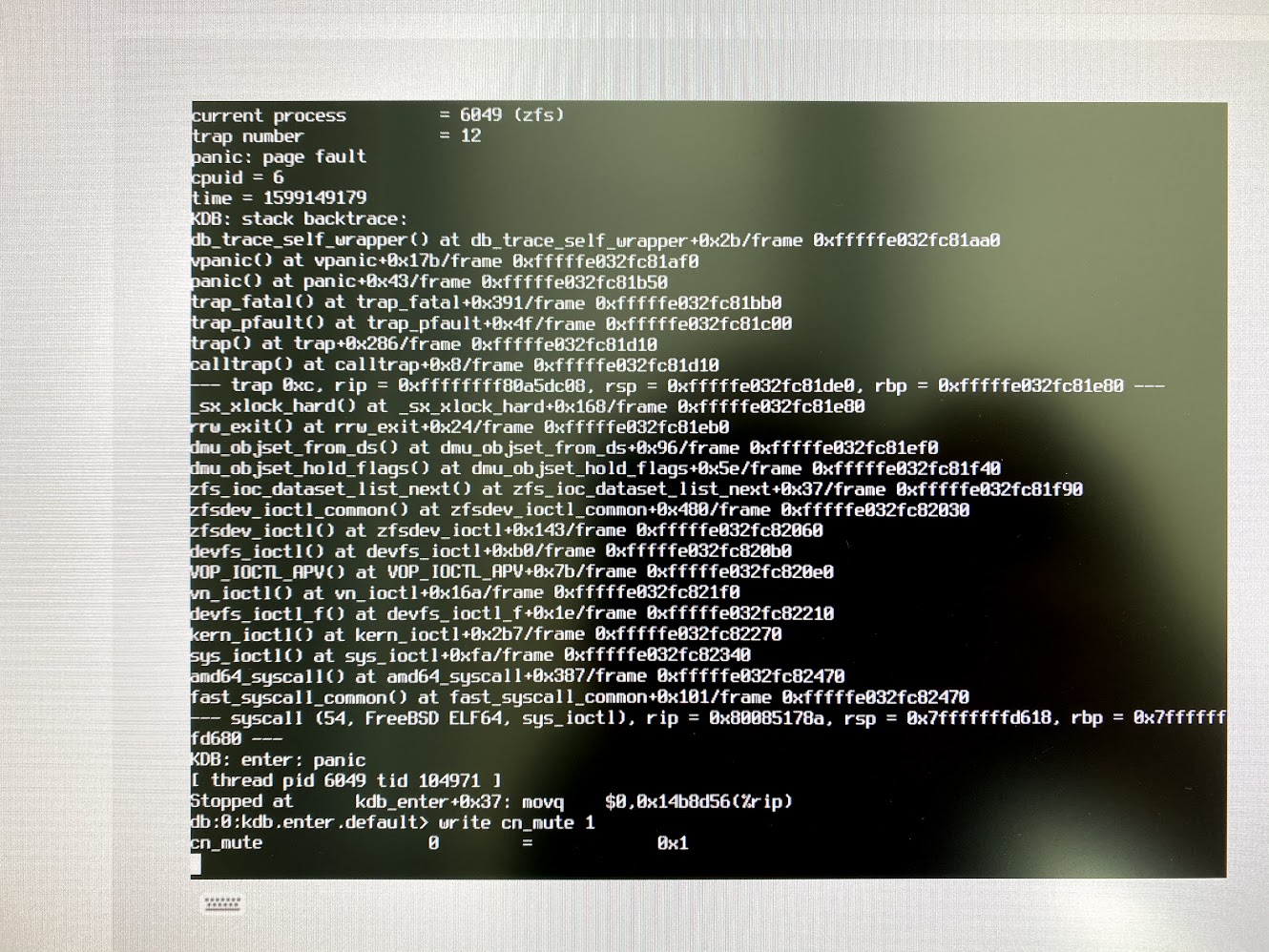

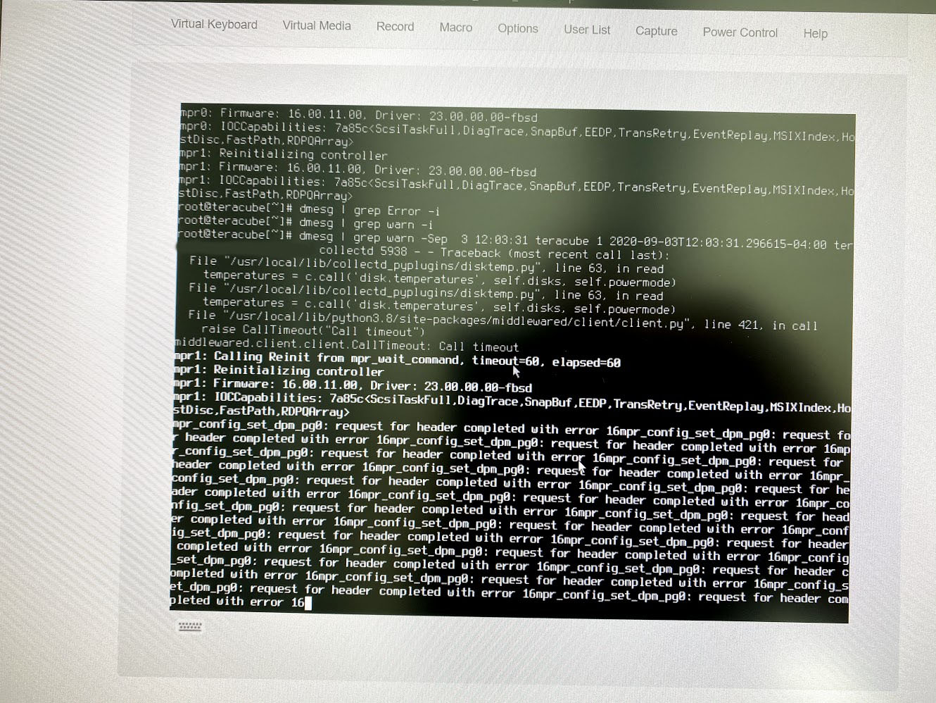

Tried different 9305-24i controllers, also a different motherboard. I was able to catch the error before a reboot.
