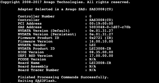

Thanks @blanchet this is my output of sas3flash -list. How do I tell which image to use?

You must use SAS3_FW_Phase16.0-16.00.12.00_Firmware/9300-8e/SAS9300_8e_IT.bin
Details
  • When I have received my X10SRH-CLN4F motherboard, the firmware was LSI3008-IR
  • After flashing to IT mode, the board became LSI3008-IT
  • But after upgrading to TrueNAS special firmware for LSI 3008, the board becomes SAS9300-8E IT
You really need to flash your LSI 3008 because you still run the IR (Raid) firmware instead of the IT (HBA) one.
Even if it may work, TrueNAS runs better with LSI 3008 in IT mode. (browse the forum for more details)
This is my sas3flash output

According to the Broadcom documentation, only sas3flash for DOS can be use to switch from IR to IT mode
Follow this guide to create a FreeDOS Live CD

Thanks @blanchet any particular reason why you went with the 9300-8e? The reason I ask is that my understanding was that the 'e' normally references external sas ports and the 'i' internal. Given the controller we have has two internal ports I would have guessed we should use the 9300-8i but perhaps Im missing something? My guess is that is probably doesn't matter a great deal.
Yes I am well aware of IT mode and ZFS this was how the server was shipped to me. However the company that shipped me the server tell me that IR mode is the same as IT mode so long as you don't create a RAID on it.
Many thanks for the advice and links its much appreciated.

IR != IT and the company that shipped it to you are incorrect in their statement
I agree: using the 9300-8i is more natural choice for an embedded LSI 3008 controller.
Unfortunately, I do not remember why I have used 9300-8e image instead of 9300-8i.
Maybe both images work.
