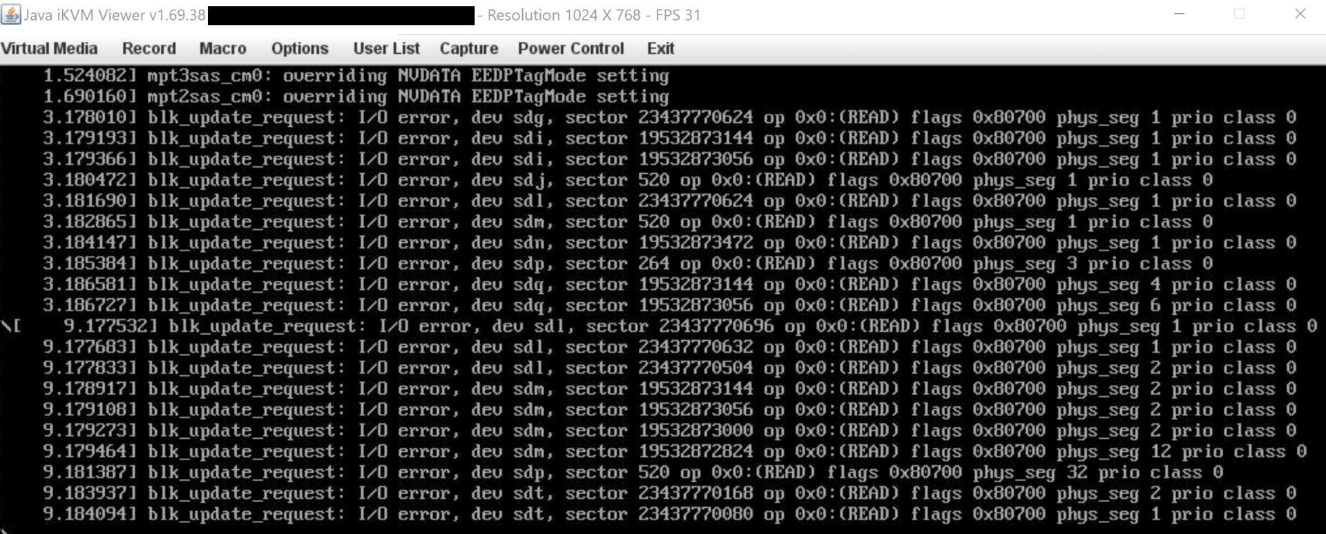

Learn from my mistake... Before flashing my first LSI-9300-8i I read somewhere in a comment that the backplane (in my case a BPN-SAS3-846EL1) needed to be disconnected, so I made sure it wasn't plugged in and I was able to flash the HBA to IT mode with 16.00.12.00 with no problems.
Did a second one three months later and forgot about that caveat, so I went through the exact same procedure but flashed it with the backplane connected. Big mistake. Now I'm getting a long list of errors on bootup, several of my recently badblocked brand new drives are suddenly reporting bad sectors (no idea why or if this incorrectly reported). The LSI-9300-8i appears to be flashed correctly. Now I'll have to see how/if I can recover the backplane, bad block all the drives again to see if there are truly suddenly bad sectors from this, no idea why that would happen. There is a possibility that this problem is only because when I did sas3flsh.efi -list, it showed the SAS address of the backplane rather than the LSI, and then when I did sas3flsh.efi -o -sasadd 50060SASADDRESSHEREXX, I flashed the SAS address of the backplane to the LSI. Apparently that can be an issue, I haven't had a chance to test this yet, fingers crossed it's this simple. But I'm concerned I'll have to somehow try to recover the firmware on the backplane. Will update as I hopefully figure out what happened and how to recover from this.

In the end I'm not sure if the backplane was affected or not. I contacted Supermicro for the firmware and flashed it to the latest firmware according to the instructions they provided. On the first attempt it didn't write to all sectors, but when I wrote to all sectors individually (except sector 3) it completed the flashing.
However, the errors on booting into Ubuntu remained the same:
For search: blk_update_request_ I/O error, dev sdm, sector 1953287056 op 0x0: (READ) flags 0x80700 phys_seg 2 prio class 0
The drives were all okay when tested in a different systems, they weren't actually damaged as this seems to suggest.
I ordered some new cables because others reported the exact same type of error and it was fixed by adding new cables (e.g. here), but no difference.
I then managed to get the backplane into a different system with a different HBA and it booted up perfectly.
Then I tried the HBA with a different backplane and the errors reappeared, so the issue must have been with the HBA. I'm not entirely sure but I believe there were some issues during bootup when plugging the HBA into the system before I even tried flashing it to 16.00.12.00. Perhaps it was damaged, or perhaps it's because it was branded as a Fujitsu CP400i, and/or it was for some reason incompatible with my Supermicro X9SCM-F. I ended up flashing it probably a dozen times in different ways, no luck (see here for extra Fujitsu-specific instructions files). In the end I returned the HBA and bought an actual non-Fujitsu (or Dell) LSI 9300-8i, let's hope this fixes it.
