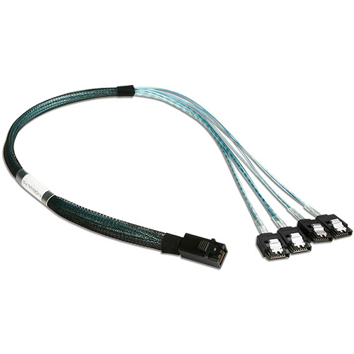

I'm using a Supermicro A2SDi-H-TP4F but I haven't found a fitting Backplane / Server chassis yet.
HoneyBadger
actually does care
Administrator
Feb 6, 2014
5,112
Hmm. Unfortunately that board is the exception to the rule and does only speak SATA on those ports, according to the spec sheet:
SoC controller for 12 SATA3 (6 Gbps) ports; 4 SATA3 ports, 2 MiniSAS HD ports
So you'll need to opt for a "TQ" or "Direct-Connect" style backplane that has 12 SATA ports, as well as get yourself a pair of SFF-8643 to SATA "forward breakout" cables - those along with the four onboard SATA ports should fully service the bays, just do some careful management internally to avoid Cable Spaghetti.
