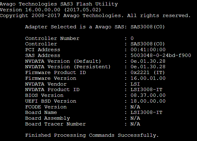

A user in this thread mentioned that I am using the incorrect firmware for my HBA, and directed me here.
However, I do not believe this applies to me, because it is a 3008 card, not a 9300. I was just looking for confirmation though.
My HBA is a Supermicro AOC-S3008L-L8E Rev2 (IT MODE) and I got the IT Mode firmware directly from Supermicro's firmware page
I don't think this has anything to do with my issues in that thread either.
You state that this only affects SATA drives, all my drives in my pool are HDD and I have not noticed any issues and have been running this card for over a year with this firmware. My boot drive is a SATA SSD however, and I assume I would have noticed major issues, which I have never.

Your card looks very much like mine in the sense of having the LSI 3008 chip on it, yet my card is an LSI 9300... the card model doesn't matter as much as the chip:

The firmware would certainly apply.
Looking at your current version, it's not only going to be the difference between the .11 and .12 fixes that you would benefit from, so my recommendation is to perform the update.

"3008" is the LSI reference of the controller chip. Controllers of the 3000 family of SAS3 controllers are found in cards of the LSI 9300 series.
So your LSI 3008 controller does belong to a LSI 9300 card (or OEM equivalent): Two different ways to designate the same thing.
And SAS2 controllers of the 2000 family are found in the 9200 series of cards.

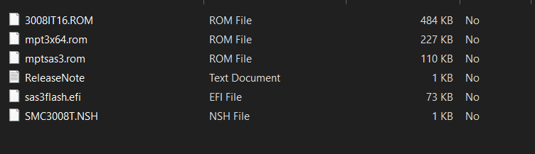

These are all the files from Supermicro's firmware release for my card.
I put the sas3flash.efi on the USB, and then the new .bin file from this thread.
Which rom file do I need from here?

Matter of taste, really. I don't like booting from SAS controllers, some systems don't like to boot from SAS controllers - but sometimes I have to. It shouldn't be harmful, but the edge cases often get complicated - multiple HBAs with different firmware versions and different extension ROMs, that sort of thing.
mpt3x64.rom is the UEFI extension ROM, mptsas3.rom is the legacy BIOS option ROM.
