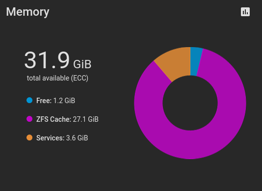

If you want ARC to use as much as possible, use CORE. It will use as much of your total RAM minus 1 GB out of the box safely without compromising system stability just like this screenshot below. Notice that free RAM is ~1 GiB. I did not have to do anything special for this.
