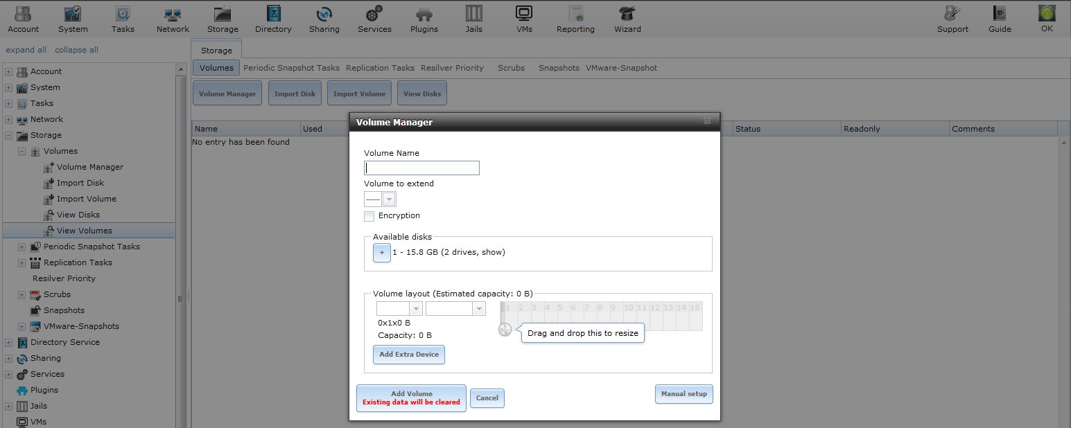

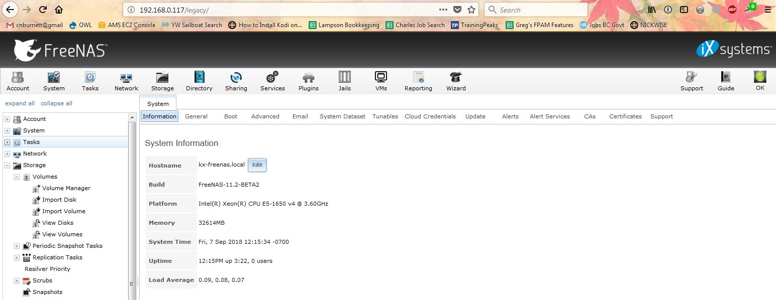

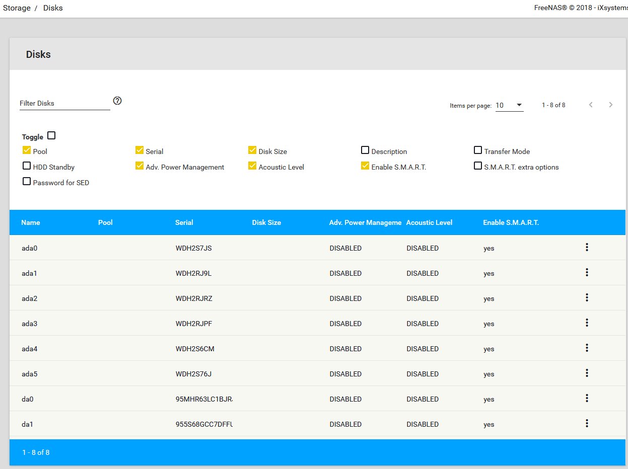

I have a newly built NAS with 2x boot USB drives AND my 6x WD 4TB drives.
FreeNAS 11.2-BETA3 (but using legacy UI as I can't find volume manager in new ui)
I am stuck trying to locate my data drives - well, get FreeNAS to see them!
Problem:

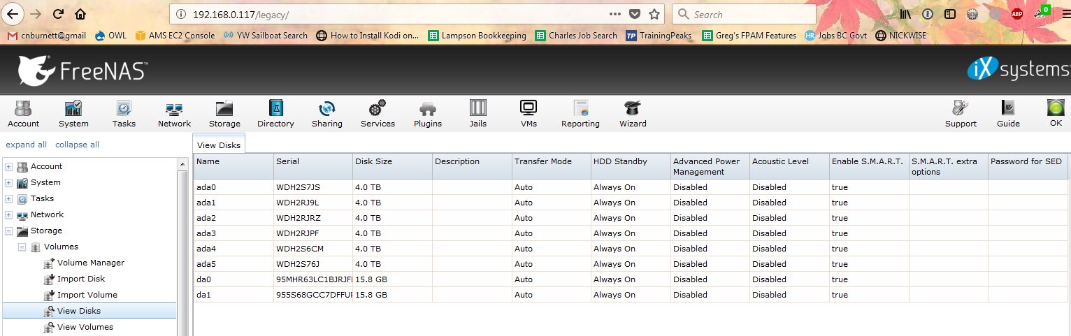

In legacy UI, I can "see" my 2 boot USB drives AND my 6 WD 4TB drives (JPG2) under Storage > Volumes > View Disks
But, when I try to add a volume, with the Volume Manager, it FreeNAS only "sees" my USB drives.
FYI:
I had previously played around with FreeNAS 11 beta and I think added a volume via the wizard... could the 4TB drives be somehow locked?
Is this something I need to do on CLI command line to free them up?

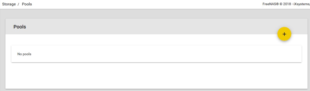

Detach is not an option, sadly... Any suggestions for my situation, where:
  • FreeNAS 11.2-BETA2, New UI
  • "No pools" listed in Storage > Pools
  • but 8 devices (2x USB boot and 6 ada0,ada1,ada2,ada3,ada4,ada,5,ada6 HHDs
Do I need to do some fdsk of other in the Shell? Like to maybe delete some old partition tables?

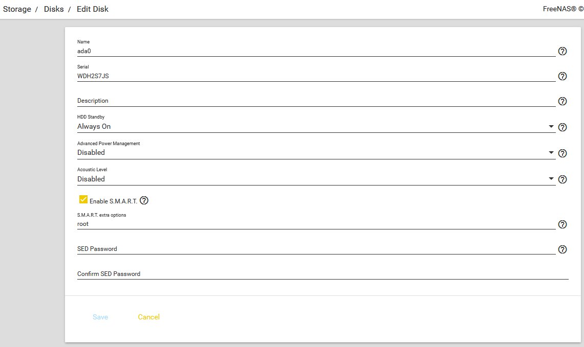

If you can see the drives in the "drives" view, there should be an option to "wipe" the disks. Just use EXTREME caution not to select the wrong drive.

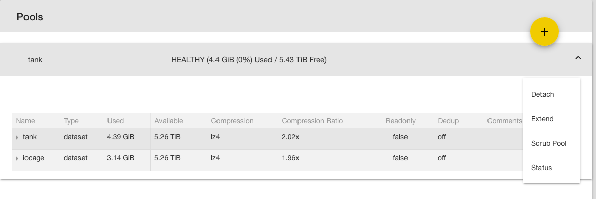

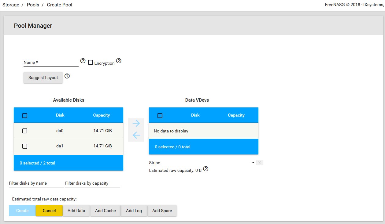

Here is the New Pool view...

Thanks @kdragon75, I am looking for wipe options... attached is view of the Edit screen for one of the drives... no 'wipe' that I can see...
