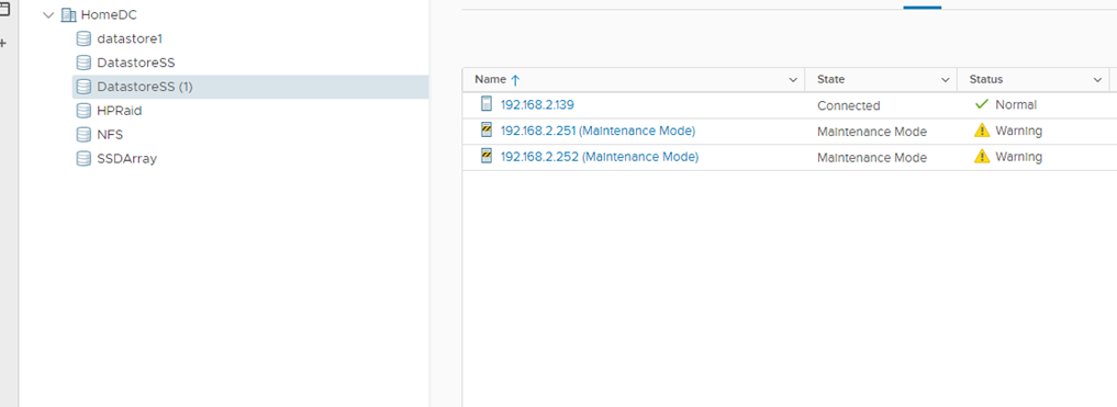

Here is where I am - Sometimes I will get (1), sometimes (2), (3) - Total chance - Not always the same Server groupings. Followed suggestions that it was mounting with IP vs FQDN..
192.168.2.250
[root@ESXI1:~] esxcfg-nas -l
NFS is /NFS from 192.168.2.30 mounted available
SSDArray is /mnt/SSDPool/NFS from 192.168.2.33 mounted available
HPRaid is /NFS from 192.168.2.34 mounted available
DatastoreSS is /mnt/SSDMirror/NFS from 192.168.2.118 mounted available
[root@ESXI1:~]
lrwxr-xr-x 1 root root 35 Jun 1 14:02 DatastoreSS -> fc367918-78daee7f-0000-000000000000
lrwxr-xr-x 1 root root 35 Jun 1 14:02 HPRaid -> 6b74e70f-0265771f-0000-000000000000
lrwxr-xr-x 1 root root 17 Jun 1 14:02 NFS -> 01a59542-83ac6997
lrwxr-xr-x 1 root root 35 Jun 1 14:02 SSDArray -> 5eafd18e-9e60111a-0000-000000000000
192.168.2.251
[root@ESXI2:~] esxcfg-nas -l
DatastoreSS (1) is /mnt/SSDMirror/NFS from 192.168.2.118 mounted available
lrwxr-xr-x 1 root root 35 Jun 1 13:45 DatastoreSS (1) -> 9cf5136d-a907d5b1-0000-000000000000
lrwxr-xr-x 1 root root 35 Jun 1 13:45 HPRaid -> 6b74e70f-0265771f-0000-000000000000
lrwxr-xr-x 1 root root 17 Jun 1 13:45 NFS -> 01a59542-83ac6997
lrwxr-xr-x 1 root root 35 Jun 1 13:45 SSDArray -> 5eafd18e-9e60111a-0000-000000000000
ESXI/FREENAS was giving it a different UUID for the symlink - but if I went to add node server into the other datastore (1) it would say it already exists - even though they are different UUID's.

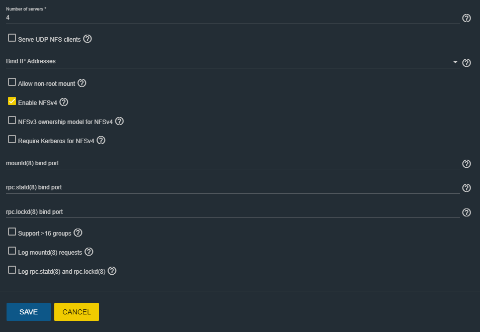

I had the same issue yesterday and something I changed made it work, I will try to figure it out:
FreeNAS : 11.2-U8
VMware : ESXi 6.5 update 3 Build 15177306
vCenter: 6.5.0.32000 Build 15259038
NFS Share:
x All Dirs
Maproot User : root
Maproot Group : wheel
security : sys
NFS Service:
x Allow non-root mount
x enable NFSv4
restart the NFS service
I did notice in the service console the error "nfsd: can't register svc name" when saving the NFS service settings or restarting it.
I did make another nfs v3 dataset/share and had that setup first with VMware mounting it. Not sure why doing a NFS v3 folder makes it happy but so far that is the last man standing. :-(
RegularJoe
Aug 19, 2013
330
I think I have it figured out now... if you apply Authorized networks it breaks something. If I have nothing and only bind NFS to my two 10 gig NICs and leave the 1gb nic for management it works fine. when I try to say the share has two authorized networks "192.168.201.0/24 192.168.202.0/24"
I now get exactly what you describe with NFS v4.1 from vCenter or from a single host and add the mount to other hosts via vCenter.
