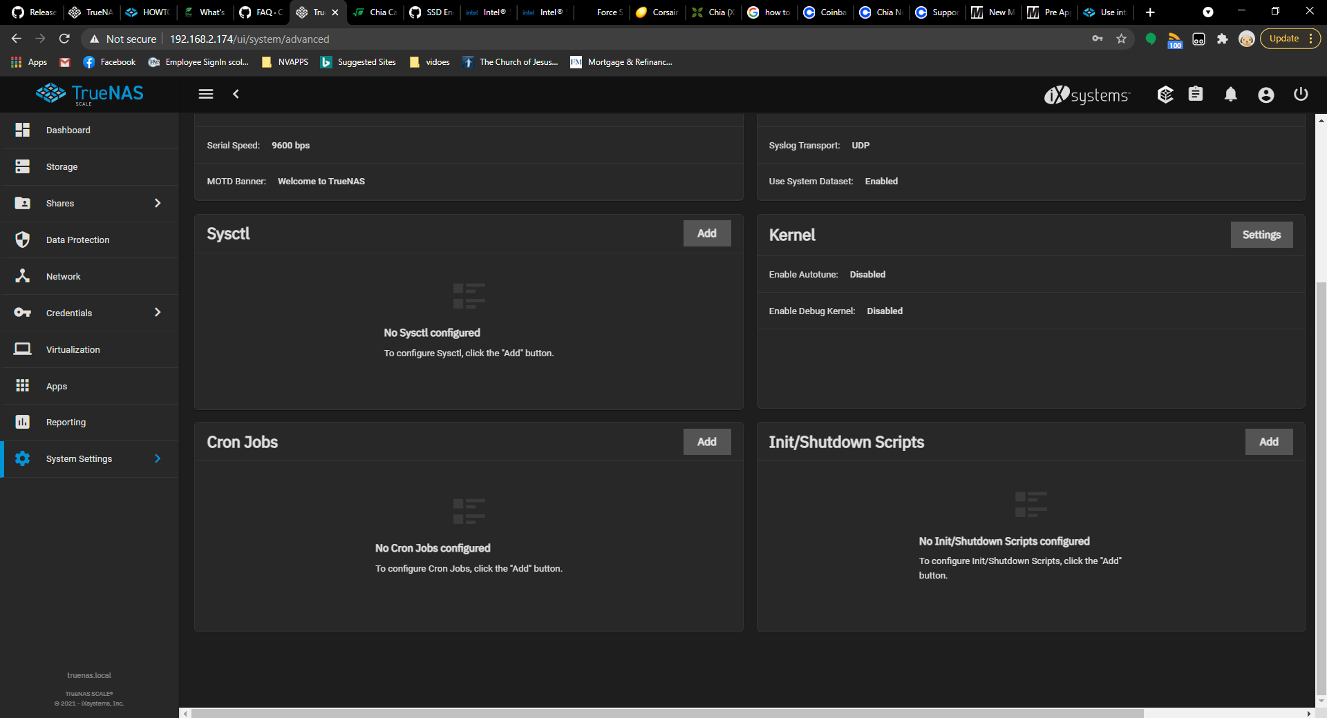

i suggest you wright up your command that you did to get it to work and use the System advanced settings until the proper fix is completed set up the command in INIT/Shutdown scripts
this process is pretty straight forward it will work through reboots and apply the resource to the kubernetes you can either run commands or create a script for now it is suggested to run it pre init. please update the above ticket or if it does not quite flow into your problem create new one and advice them of what you had done to overcome the limitations.

midclt call -job chart.release.update 'plex' '{"values":{"gpuConfiguration": {"intel.com/gpu": 1}}}' should add support to the kubernetes deployment
just replace 'plex' with the name of your plex app name the number rep how many gpus that container can use so if you have more than one increase that number of if my memory is right that is the first gpu that is loaded so if it is 2 it will allow the second gpu to be used.

Unfortunately the post-init scheduled tasks run before the middleware has started. When the middleware starts it is explicitly deleting the Intel GPU plugin if it doesn't detect an Intel GPU. I may need a script that sleeps for some amount of time, applys the plugin, and restart the Plex container.
