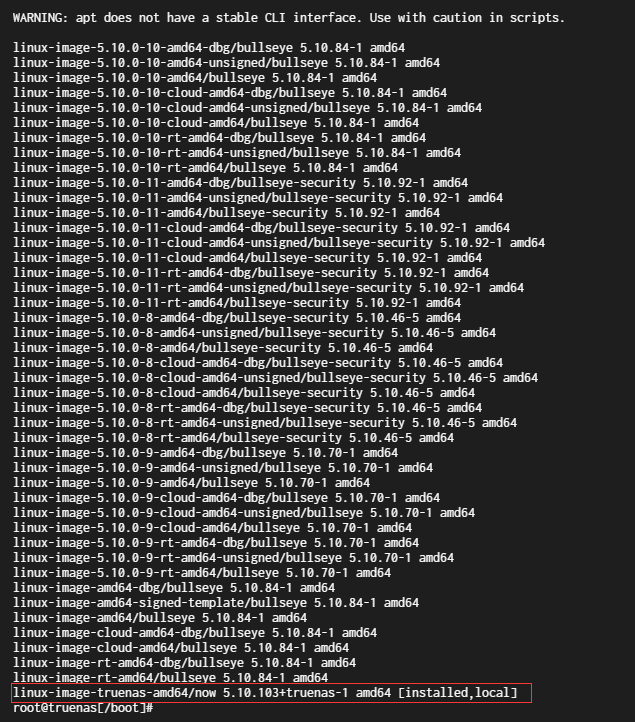

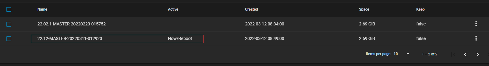

Thanks for your quick response!
I have just updated to nightly version. But the latest version of kernel I can find in the apt source list is 5.10.103. Would you tell me how to update truenas image into 5.15. Thank you! :)
Kris Moore
SVP of Engineering
Administrator
Nov 12, 2015
1,471
Ahh, I jumped the gun. It hasn't merged yet, but will be in near future. Give it another week and check back :)
