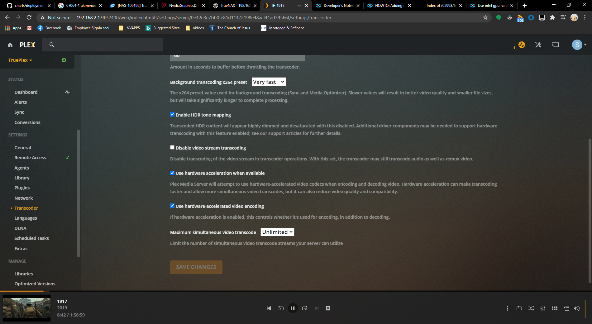

The pod will restart, and your plex instance should now use hardware decoding and reduce your CPU usage !
Don't forget that you need a Plex Pass for this feature, and you need to enable it in the settings.

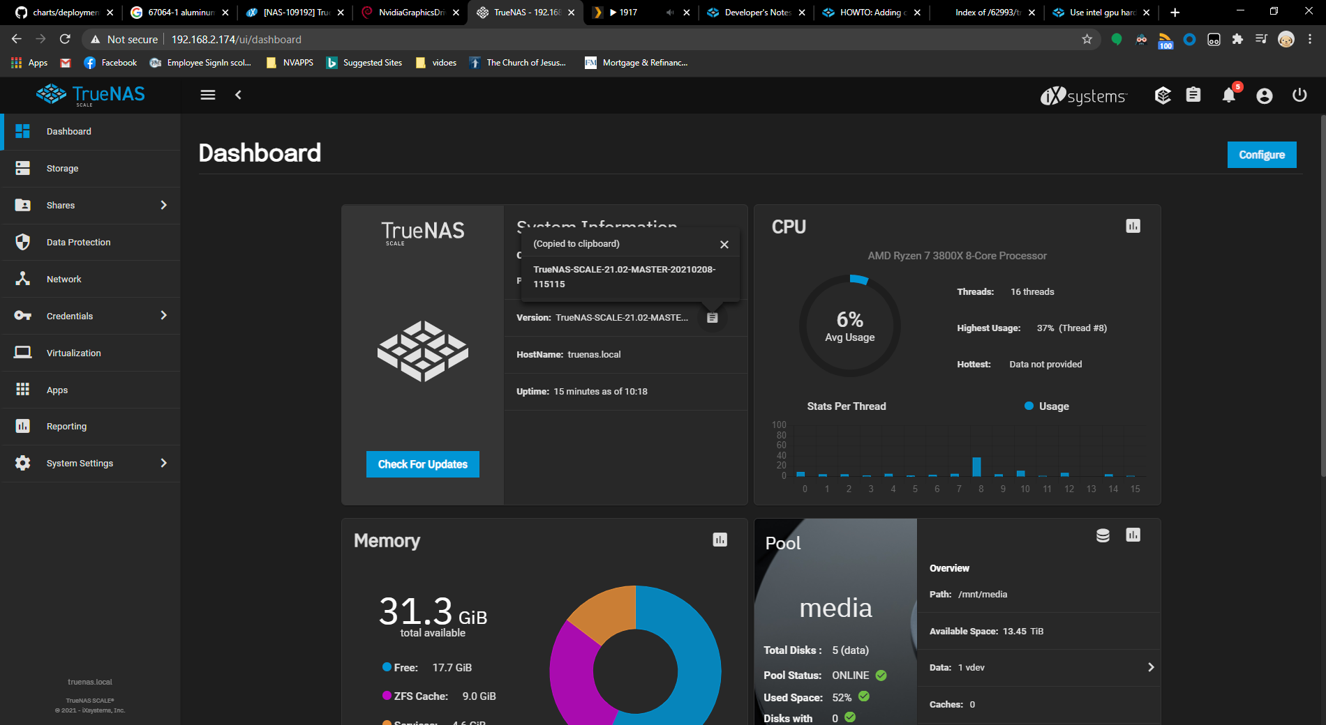

I'm on TrueNAS-SCALE-21.02-MASTER-20210205-112916

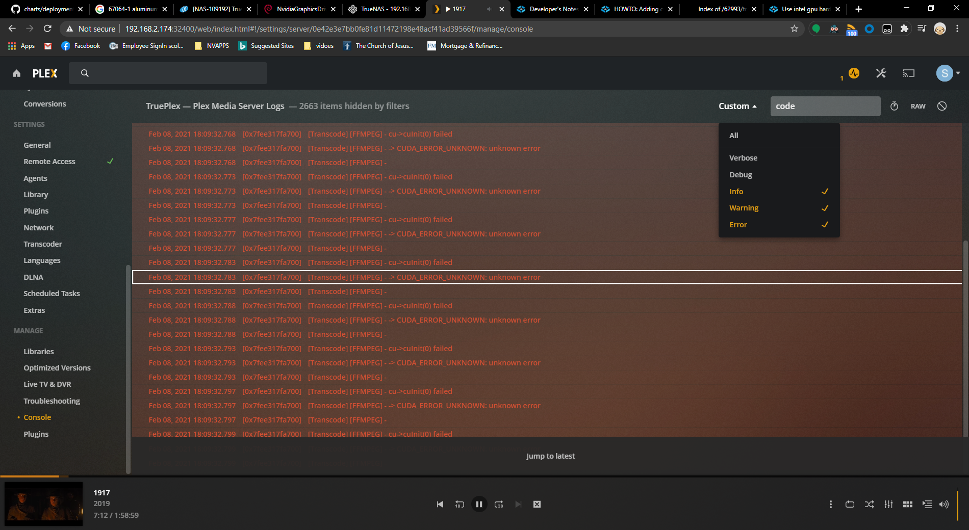

i can confirm that running the TrueNAS-SCALE-21.02-MASTER-20210208-115115 running plex app using the latest docker image pull from plexinc hardware acceleration will not work without cuda or toolkit you might have an app that has the built in requirements. but under the latest pull you can expect hw will not work. verify this buy loading plex up with latest tag and check the console search for code check warning, errors, info, and you will see what i see see attached img
the issue lies in the loaded .so files in ldconfig app is calling for them and can not find or have access to them but if you build the image with them in there and you have exposed the GPU to the container if you have to required apps installed it will work but the host system should be the one to contain all driver's and toolkits for gpu support in Docker i have added support to to proxmox witch is where i learned a lot about nvidia and how to get it into LXC or Docker k8s is a different ball all in itself it uses both api level resource allocation and docker you must meet all docker requirements and k8s before you can get it to work

the above just after install of cuda and tool kit you will see i ran my command to find folder and to run nvidia-modset and it added folders to /dev location
truenas# kubectl exec -n ix-plex2 --stdin --tty plex2-66c494f884-w64b2 -- /bin/bash
root@truenas:/# ls -la /dev/nvidia*
crw-rw-rw- 1 root root 195, 254 Feb  8 18:04 /dev/nvidia-modeset
crw-rw-rw- 1 root root 195,   0 Feb  8 18:04 /dev/nvidia0
crw-rw-rw- 1 root root 195, 255 Feb  8 18:04 /dev/nvidiactl
root@truenas:/#
is what the app looks like before restart.
after restart what app looks like and HW acceleration is working
