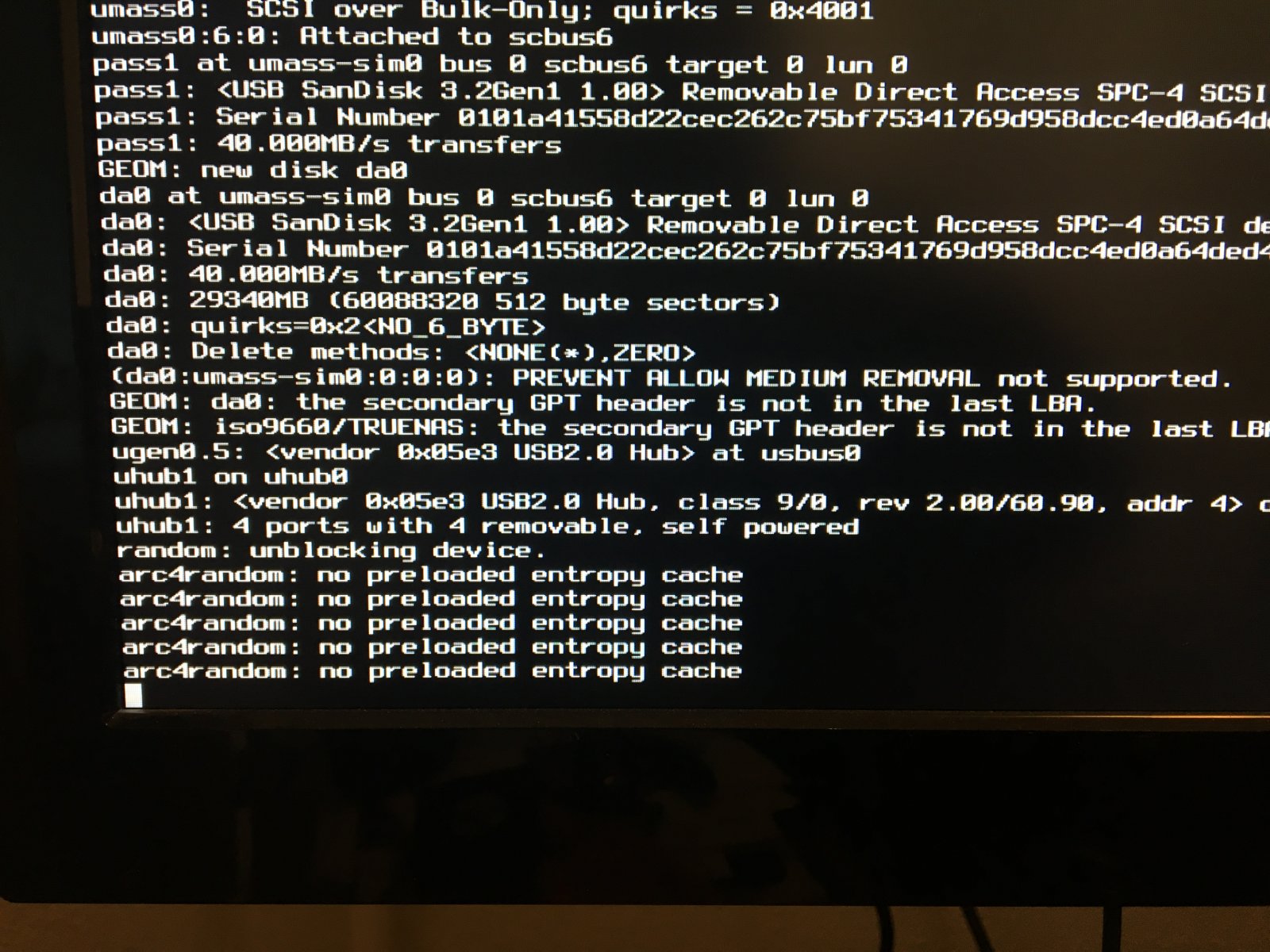

Hello everyone,
I've been trying to install truenas core on my system but so far I'm stuck even before the installer menu opens. See screenshot about where it gets 'stuck'.
It's not actually unresponsive because I can plug/unplug a USB device and it will still respond to that with some extra lines but it will never get to the setup screen that I'm expecting to see.
I was using one of those SD card adapters as a USB because that was what I had lying around but I've already bought a real usb stick in the hope that that might solve it but without any luck. I've tried Truenas 13 and 12 but they both seem to stop at the same point. "uhub1: 4 ports with 4 removable self powered" is to be the last line for Truenas 13 and for 12 it continues to spit out 5 arc4random lines and then stops altogether.
I've made boot USB drives with balena etcher on MacOS and with rufus on windows but all seem to get stuck at the same point.
Then I started to doubt if my hardware had any defects so I installed Ubuntu but that didn't show any problems at all. Everything seems to work perfectly.

Ok so I've finally got time to investigate this some more and I found this is not a truenas issue but something that is also present in freeBSD. I've installed a freeBSD image on a USB stick and the bootloader looks identical and I get stuck at the same spot.
Reading through the freeBSD forum I've found the following lead:
https://bugs.freebsd.org/bugzilla/show_bug.cgi?id=264179
Next step is to figure out how to change the config file on an ISO in macOS. My windows workstation currently has no graphics card/PSU because I borrowed that for the display output for the machine I want to run truenas on... :confused:

Any options to solve it in the console?I have some control over the system when I load the original truenas image and I press escape in the bootloader but so far I haven't figured out if editing /boot/loader.conf is possible.
Jul 16, 2022
6
Ok so I'm an idiot. In the bootloader you can set a variable with 'set hint.em.0.disabled=0' to ensure that the NIC doesn't load and type 'boot' for the machine to boot. It does allow me to install truenas now and I've also been able to boot into it and edit the /boot/loader.conf with ee texteditor and add the line so it automatically ignores the NIC at boot. This leaves me with a system without a network controller though which is not really useful for a NAS.
