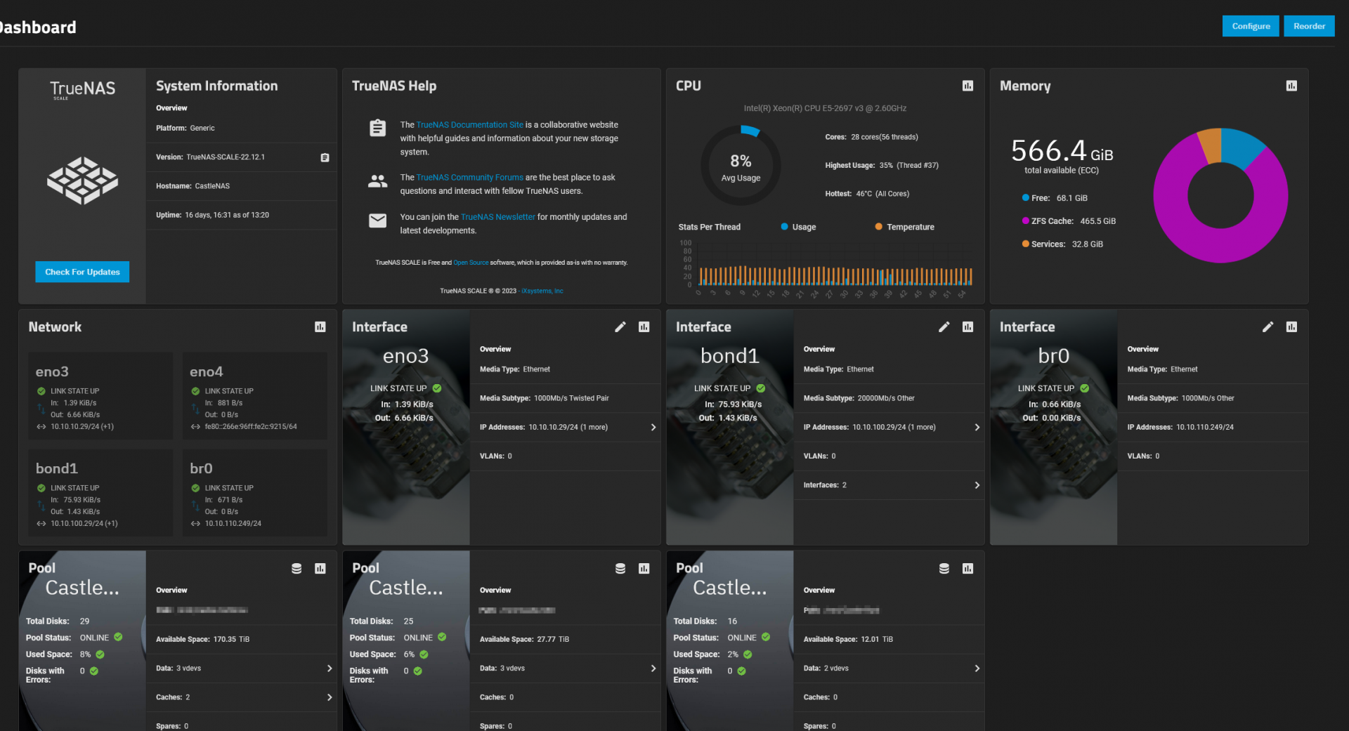

Anyone else run into an issue where they were manually setting there ARC ZFS min and max size via CLI, and it is no longer working post upgrade? I noticed it post reboot even though I set it up under System Settings --> Advanced --> Init / shutdown scripts to run the commands on boot. I manually reran the commands from the CLI and they executed without error, but the amount of memory being used is not changing.
Anyone else run into a similar issue?
Xero7650
Feb 8, 2022
14
if you re-run the commands manually, it will eventually work. However saying that, Ive seen free ram creep back up to half un-utilized leaving me with 256GB of RAM free (no reboot).
I then re-run the commands from the shell, and it starts working again.

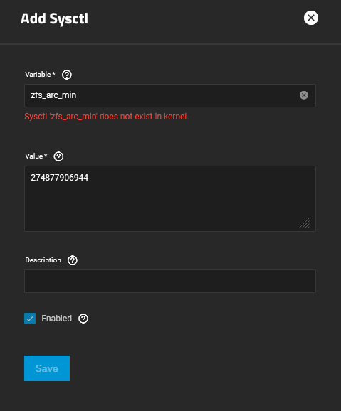

Cron jobs and post-init scripts always worked for me prior to 22.12.1. Can you shed some light on what to input in the variable field for sysctls to set the max arc size?

do I just use the variable name and set the value? Meaning the following:
Setting Name: zfs_arc_min Value: 274877906944
or do the value keypair names change when you move to sysctls?
Thanks for the info!
Xero7650
Feb 8, 2022
14
I did some digging and i'm not seeing any tuneable for arc via sysctl - so definitely could use a pointer.

The tunables listed in arc_summary do not work as listed in sysctl on Scale. When trying to enter zfs_arc_max as a variable, Scale reports, "
Sysctl 'zfs_arc_max' does not exist in kernel."
Perhaps that only works on Core and not on Scale? As far as I can tell, there are no sysctl tunables for zfs on Scale. If there are, please give me an example that works so I can try it out.

Core and SCALE probably work different here.
Unless something has changed ticket NAS-116472 still applies and you can't do this in the UI for tunables on SCALE.

You can do some workaround like this:
sudo sh -c 'echo NEW_ARC_SIZE > /sys/module/zfs/parameters/zfs_arc_max'
