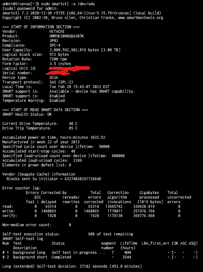

I have spent the last few days ill and working on a few projects I had on the back burner - one of them being a NAS setup. I have four Hitachi 3TB SAS drives on a Dell H310 flashed into IT mode. My motherboard is an Asus board running 2x4GB DDR4 and an i5-7500. If the motherboard model is relevant I can find it, but I do not immediately have the model in front of me. The model of the Hitachi drives, which are 7200 RPM, are HMRSK3000GBAS07K. Attached is an example smartctl -a output - I'm getting functional outputs for every drive. Note that I'm running a full smart test on them right now, which is accurately reflected in the output.
I have seen people with this issue with both core and scale, and have tried a few things. What I find most odd about this issue is it came about following an sg_format of the disks from 520 to 512 byte sectors - they were reporting accurately before.

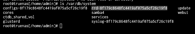

Under /var/db/system, do you have multiple rrd-* directories?

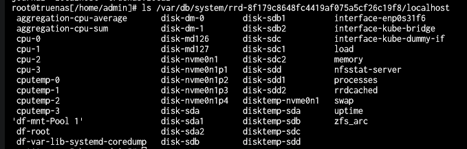

This is brute force, but try stopping collectd and rrdcached via service collectd stop and service rrdcached stop. Then cd /var/db/system/rrd-8f179c8648fc4419af075a5cf26c19f8/localhost. There should be folders for all the reporting categories. Delete them all via rm -rf *. (Make sure you're in the localhost folder before you try the delete.) Then restart the collectd and rrdcached processes via service collectd start and service rrdcached start to have the Reporting rebuild all the folders.

This is cursed. Stopped services, pulled a whole copy of the rrd folder, wiped the rrd localhost folder and started the processes, no dice. Rebooted, no dice. Cleared out the whole rrd folder for the heck of it, still no dice. Put back the journal and truenas.local folders, still no luck. Everything is reading null.

Did the folders repopulate, and are there *.rrd files in each folder?
SmurfHunter
Feb 28, 2023
12
Localhost I left deleted and it repopulated. Screenshot of all the folders that are inside the folder.

OK, within each of the folders there should be files with .rrd extensions; this is the actual graph data. If there are, then the Reporting graphs should eventually repopulate. If there aren't, then there's a different problem going on.
