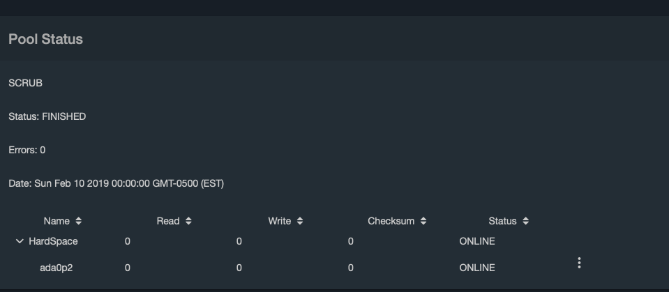

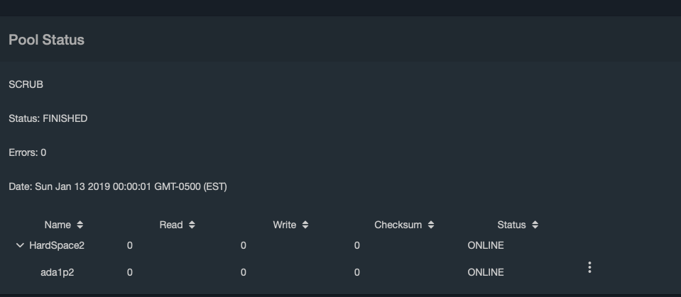

... from the dashboard... Storage / Pools / Pool status

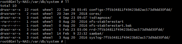

Additional NIC: MELLANOX 10GB CONNECTX2 - MNPA19-XTRThe config db file is namedImpossible for me to say. Lots of threads about replacing failed boot drives and sounds like config db is often backed up so maybe your odds are good.

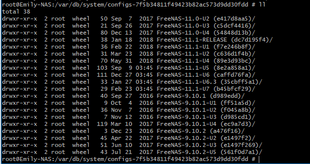

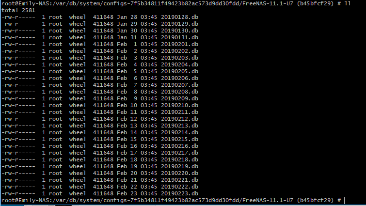

freenas-v1.db and is located at: /data/var/db/system/ plus another directory that will be named configs-****random_characters****.
cd FreeNAS-11.1-U7\ \(b45bfcf29\)/

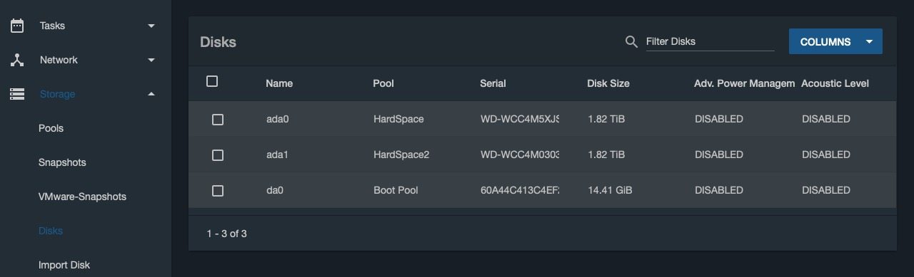

I was looking at the drive configuration and I am wondering if you realize that you have no redundancy in this configuration. Normally, it would be better to have the drives mirror each other so there is redundancy of in the ZFS storage to allow for error correction if anything goes wrong with one of the drives.here are both drives
