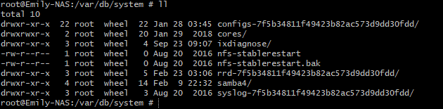

The config db file is named freenas-v1.db and is located at: /data
However, if that directory is located on the USB boot device that is failed, this may not help at all.
You can recover a copy that is automatically saved for you in the system dataset, if the system dataset is on the storage pool.
For people like me, I moved the system dataset to the boot pool, this is no help, but the default location of the system dataset is on the storage pool.
If you do a fresh install of FreeNAS on a new boot media, and import the storage pool, you should find the previous config db at this path:
/var/db/system/ plus another directory that will be named configs-****random_characters****.
Mine looks like this:

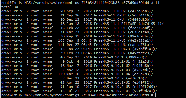

Inside that long random number named directory is the history of all you old configs, like this:
It is kind of tricky to cd into one of those directories because you must "escape" some of the characters, so the command looks like this:
cd FreeNAS-11.1-U7\ \(b45bfcf29\)/

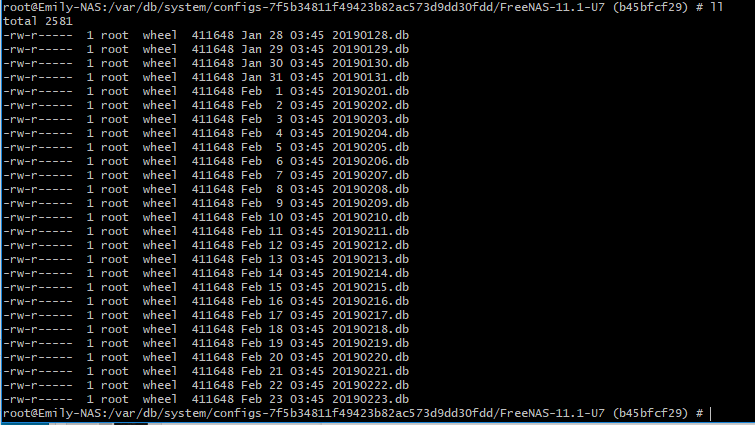

Inside there, is a history of the config databases named by date like this:
I hope this can help someone.

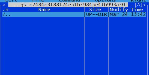

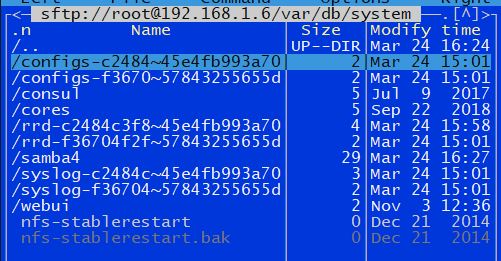

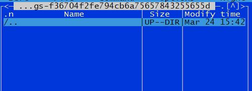

Hi Chris, I'm trying to follow this but get lost after root@FreeNAS[/var/db/system]# .
Here is what the path looks like on my system, but the long random numbers in this will be different for your system:
cd /var/db/system/configs-7f5b34811f49423b82ac573d9dd30fdd/FreeNAS-11.1-U7\ \(b45bfcf29\)/
and this is the directory at the end of that:
root@Emily-NAS:~ # cd /var/db/system/configs-7f5b34811f49423b82ac573d9dd30fdd/FreeNAS-11.1-U7\ \(b45bfcf29\)/
root@Emily-NAS:/var/db/system/configs-7f5b34811f49423b82ac573d9dd30fdd/FreeNAS-11.1-U7 (b45bfcf29) # ll
total 5365
-rw-r-----  1 root  wheel  411648 Jan 28 03:45 20190128.db

-rw-r-----  1 root  wheel  411648 Mar 14 03:45 20190314.db
-rw-r-----  1 root  wheel  411648 Mar 15 03:45 20190315.db
-rw-r-----  1 root  wheel  411648 Mar 16 03:45 20190316.db
-rw-r-----  1 root  wheel  411648 Mar 17 03:45 20190317.db
-rw-r-----  1 root  wheel  411648 Mar 18 03:45 20190318.db
-rw-r-----  1 root  wheel  411648 Mar 19 03:45 20190319.db
-rw-r-----  1 root  wheel  411648 Mar 20 03:45 20190320.db
-rw-r-----  1 root  wheel  411648 Mar 21 03:45 20190321.db
-rw-r-----  1 root  wheel  411648 Mar 22 03:45 20190322.db
-rw-r-----  1 root  wheel  411648 Mar 23 03:45 20190323.db
-rw-r-----  1 root  wheel  411648 Mar 24 03:45 20190324.db
I have 2 folders that start with configs but they're empty. Look at attached pictures.

well, the idea did 'work' in that in started populating backups in one of those folders in /var (as in the post above), but it only has a backup with today's date on it. I'm guessing it wasn't storing this data where I'd like previously, so there is nothing to pull over and surface.
I appreciate the help... I'll just have to manually set up users and install Plex again and let it run as it does. I'm just glad I didn't lose all of my data.
