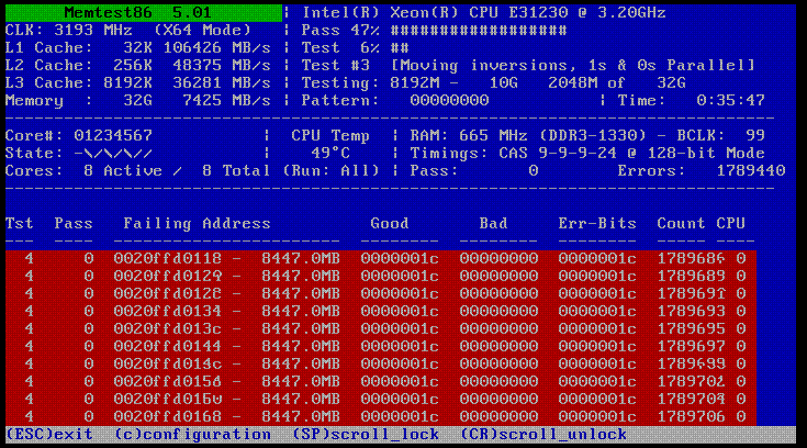

There have been lots of reports that the Kingston DDR3-1600 product (specifically KVR16E11K4/32) hasn't been working with Haswell systems like the SuperMicro X10 boards.
We haven't had reason to order an X10 based board, but as some of you know we got an ASRock Avoton board in a few weeks ago. This board IS on the Kingston web site under their compatibility tool. This failed rather spectacularly with the set of Kingston DDR3-1600 we had in inventory as spares.
I decided I didn't want to bring another 32GB of memory into stock just to test, so this morning I downed one of our X9SCL+'s and stuffed the DDR3-1600 into it along with a gen 1 E3-1230 (which would run it at 1333).
Failing on two boards it is listed as working with. Dunno!
