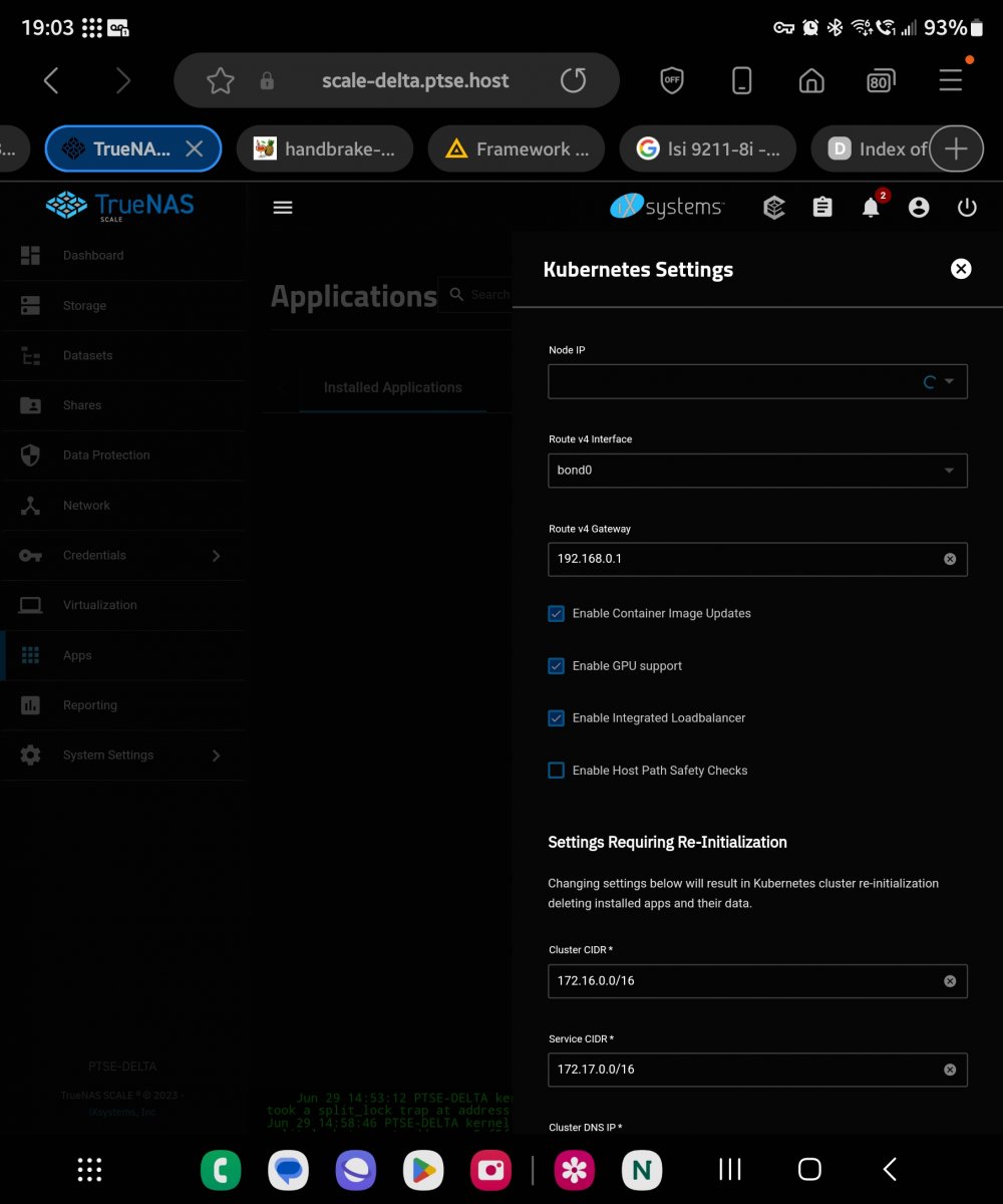

Uh, if that happens with other apps, consider reinstalling TrueNAS completely with a fresh .iso. (Choose upgrade and then it will ask you if you want to format the drive beforehand. Choose yes and it will reformat and then do a fresh reinstall of TrueNAS but without loosing your config.)
I had a similar issue and that fixed it.
Also make sure you have set your server's internal IP in advanced settings under the apps tab.

Thank you very much my friend for all your help. I added DEPENDENCY and the issue was solved with Zerotier. I have it working and when I reboot everything still works fine. Much appreciated.
